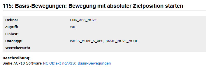

Alarm "Read access for write_only parameter; ParID: 115

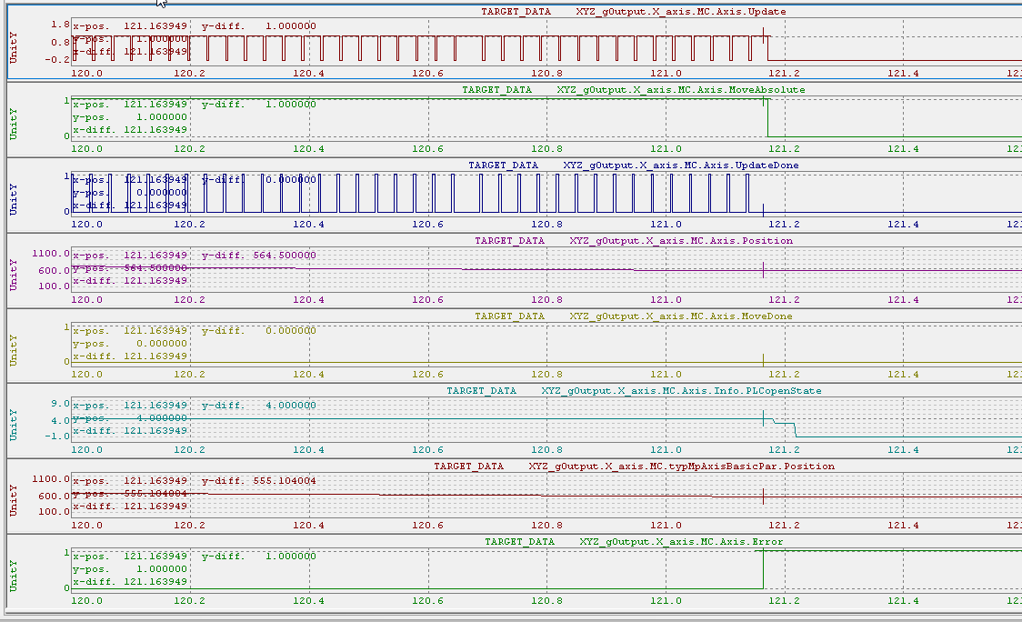

I’m “synchronizing” to a virtual axis that is controlled using MpAxisBasic. I perform a Move Absolute, and when the position of the virtual axis changes, I update the position accordingly—so the position is updated while in motion.
This worked quite well, but after a recent update, I’ve started receiving a strange message a couple of times a day:
“Read access for write_only parameter; ParID: 115”
Previously, I was using MappMotion 5.24.1, and now I’ve upgraded to 5.28.2. Could this be causing the issue? I noticed that 5.29.0 is also available.

In 5.28.2 i found that they modified things:
  • MpAxisBasic: Combination of the commands “MoveAbsolute” and “Update” can lead to a PageFault
    Under the following conditions, MpAxisBasic may cause a PageFault:
    • The function block MpAxisBasic is called in a task class that is slower than the task class mappMotion
    • The “MoveAbsolute” command is reset during the active movement and causes a halt.
    • The “Update” command is called independently of all commands if a parameter changes,
    • The change rate of the “MoveAbsolute” command is very high, i.e. the command is constantly set and reset and the parameters are changed in parallel.
Can this be the reason, it’s not clear for me what they mean by PageFault.
On the 4 conditions these are my comments.
  • MpAxisBasic I’m calling in task 1 in 4ms.
  • The “MoveAbsolute” command is reset during the active movement and causes a halt, is not what i’m seeing.
  • update i’m only sending when position is changing, not already an update is busy and the axis is in mcAXIS_DISCRETE_MOTION state.
  • The change rate of the “MoveAbsolute” command is very high, i.e. the command is constantly set and reset and the parameters are changed in parallel. This can be when it’s reaches position i will check.

This Error Message is quite interesting as it states that something on that plc tried to read ParID 115 which is only writeable.
I think you will not have used a ReadParID function to do that, so it means that the MotionSystem itself maybe did this by mistake.

Out of the Logger we can see that you hit the MoveAbsolut very often in short intervalls. This should not be a problem of the system, it should be able to handle it.
But in general this “coupling” use-case should not be implemented in this way. There are different possibilites to do it, like cyclic-position or gear-in.
If you know it is reproduceable in simulation (ARsim) it would be geate. Because if it is good protable it should be investigated by B&R support. It could be an not intended affect of an other Bugfix.

I was able to capture a trace when the error occurred.
I think I’ll first update MappMotion to version 5.29. If that doesn’t help, I’ll roll back to 5.27 or even 5.24 and investigate further from there.
