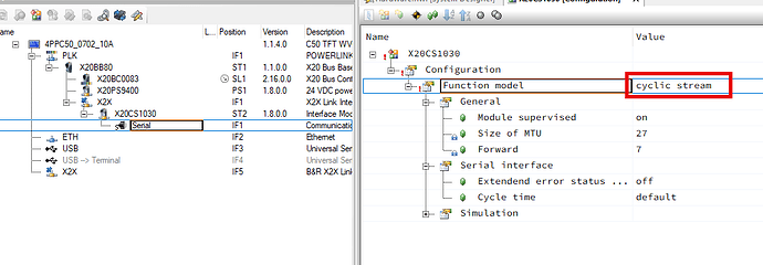

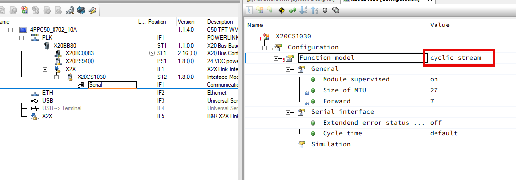

Hello Christoph, I have a doubt about your response. If we use the module X20CS1030 in combination with a 4PPC50+X20BC0083 can we use the libraries that you mentioned? specifically DRV_mbus.
I’m aware that the 4PPC50 has a variant with the RS485/RS232 interfaces included but the lead time is a bit high for an urgent project.
Thank you.
Hello @Salvador_Flores,
with this setup you’ll get a ‘stream’ function model which is ideal for DvFrame and its wrappers.
Thank you very much for your help. Greetings
