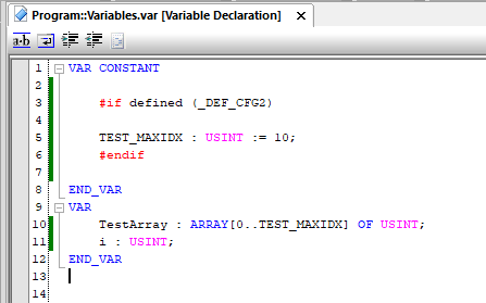

hi, @michael.bertsch is this also usable for defining global constant that is used as array index for variables? because the use case there is more simple as it is just a assignment of variable.
i am not an expert on this, i only provided a link to the other thread.

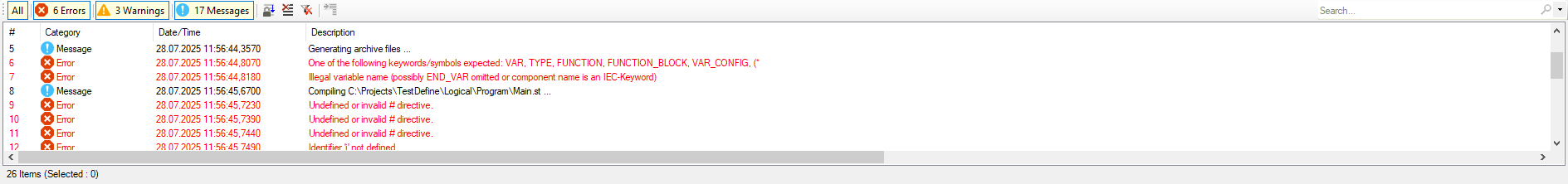

I think you would like to do this… a Define used in a .var File. → My Test showed that Automation Studio is not happy about it an throws some Errors. Also the SmartEdit marks it as red.
In ST-Code the Define is maked as Blue.
