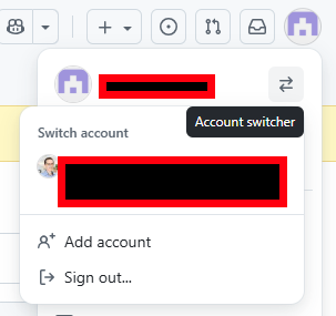

Hi @stephan.stricker
I tried to create a new issue for the migration script but got an error message: “Unauthorized: As an Enterprise Managed User, you cannot access this content”
This is the issue I am trying to raise:
After running the “Create mapp folders” script for an AS 4.12 project, the first line of Cpu.pkg gets changed from
<?xml version="1.0" encoding="utf-8"?>
to
<?xml version='1.0' encoding='UTF-8'?>
Double quotes should be used to surround xml attribute values, not single quotes.
That way this is parsed is one and the same from the Automation Studio side. But as this is written just as plain text it should be quite easy to change.
If you only have an ABB enterprise user and want to raise issues/contribute, you would have to create a “standard” non enterprise User that you can use in parallel on Github.
And then use the account switcher to switch back and forth:
Thanks for that note. For AS the quotes should not make a difference. It seems that the issue with the folders if fixed in AS 6.3 so the question is probably if we should remove the folder detection and remove the script entirely.
