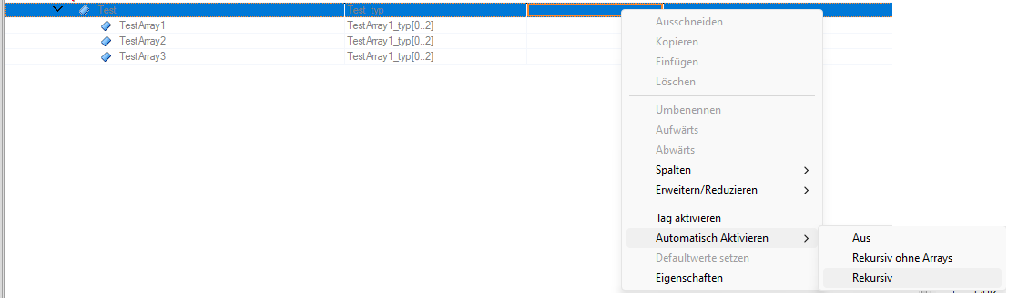

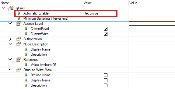

Hello
I have an array specifically for OPC variables, which should basically be recursive. It’s not a problem as it is now, but it’s just cumbersome to enable everything individually in nested structures.
Oliver
I am not an OPCua specialist… but as i made some other tests for it at the moment, i just tried your use case in AS6.3.4.
I made a Structure with a lot of Arrays in multiple Layers.
Then i made one klick in the Default View to enable all Arrays and SubArrays.
Before Enabling
After Enabling
Was this the asked behaviour?
Hello
Yes this is the Setting i was looking for, thank you!
