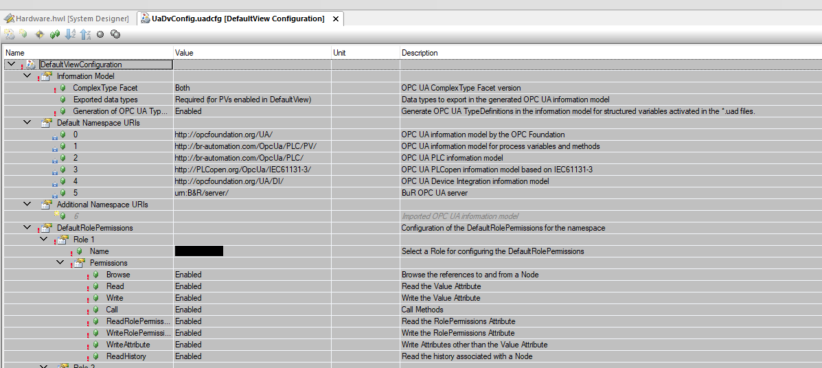

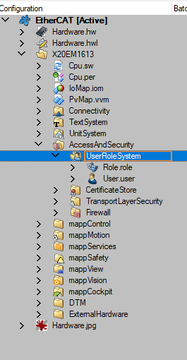

I do believe you have to set up a user and role here:

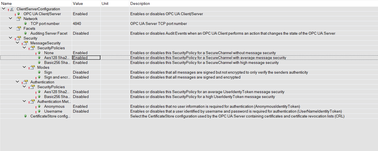

Afterwards you have to enable the roles in the OPC-UA server config:

how can I login as a Anonymous without an user and password? Because I have not setup any user
You could find the answer in this community topic.
