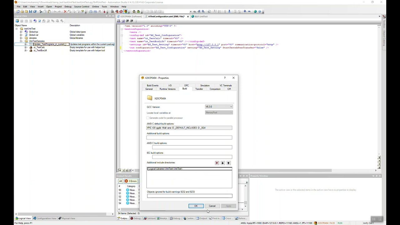

Available Test Items field is empty
Hi!
I am trying to implement some unit test codes and run them, but the “Available Test Items” field is empty upon opening the Unit Test Page. When I try reloading available tests an error message pops up that tests could not be requested from http://127.0.0.1:80. Although the target is online, target status is in RUN mode, unit test solution is installed, B&R Web server is enabled and the requested port matches the configured one, still nothing can be seen on my window. I am not exactly sure how the testing works, where the test items are coming from and why I do not see them.. Can somebody help me find my test cases?

Thank you for your prompt answer! I’ve watched the videos and went through the unit test section thoroughly and learned new things, however the initial issue hasn’t been solved. I created a new, blank project with only the sample tests in it and tried to execute those cases but the situation is the same. I can see the configured sample test items but that is just because there is a test configuration xml by default in the working directory. Once I delete the xml file, I cannot retrieve them. I also tried configuring Opc Ua, changed TCP port number and tried to reload available test items with the new configuration… unsuccessfully.
