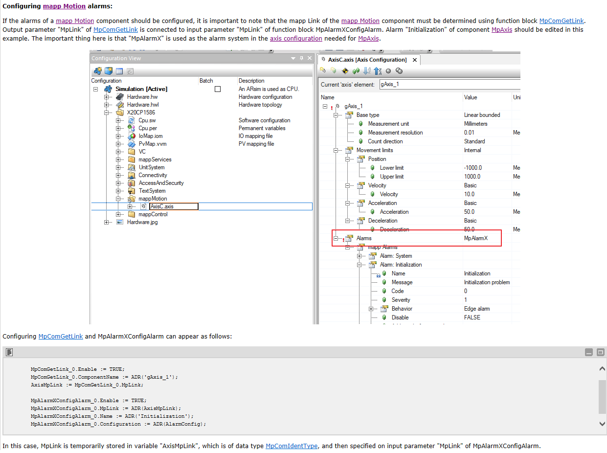

the FBs MC_BR_ProcessConfig as well as MC_BR_ProcessParam can not cover this use-case of changing the MpAlarmXConfiguration of a mappMotion axis component.
But in the mappAlarmX documentation I have found some quidance which could help you with that:
Please check following path in AS help: B&R Online Help
Under point “Configuring mapp Motion alarms“ it is explained how such alarms for an axis can be configured/adjusted:

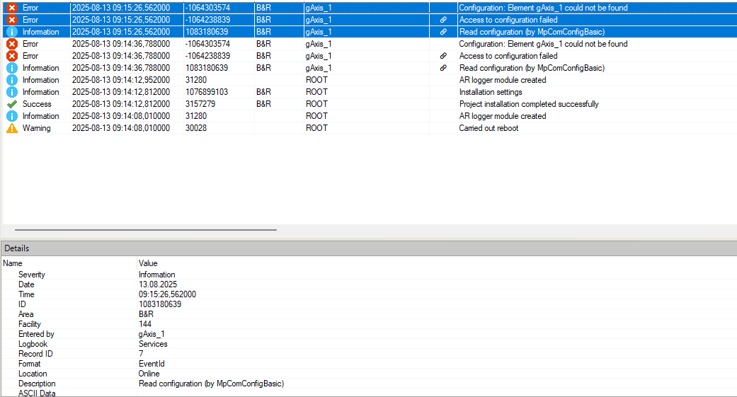

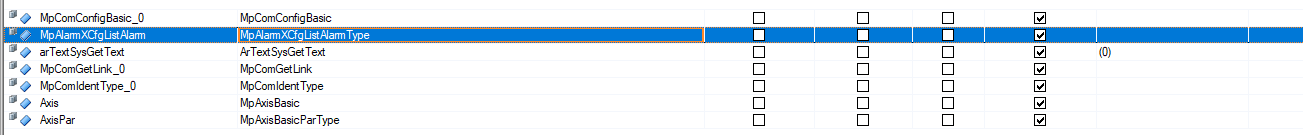

thank you for your advice. I forgot to add the information that I use AS6.3/Mapp 6.3. Unfortunately there is no Information in Help V6.
I was trying to adapt it to “MpComConfigBasic” but this isn’t working.
Here is my attempt:
Cylic:
VAR:
Logger:
If anyone has an advice I would be very grateful.
