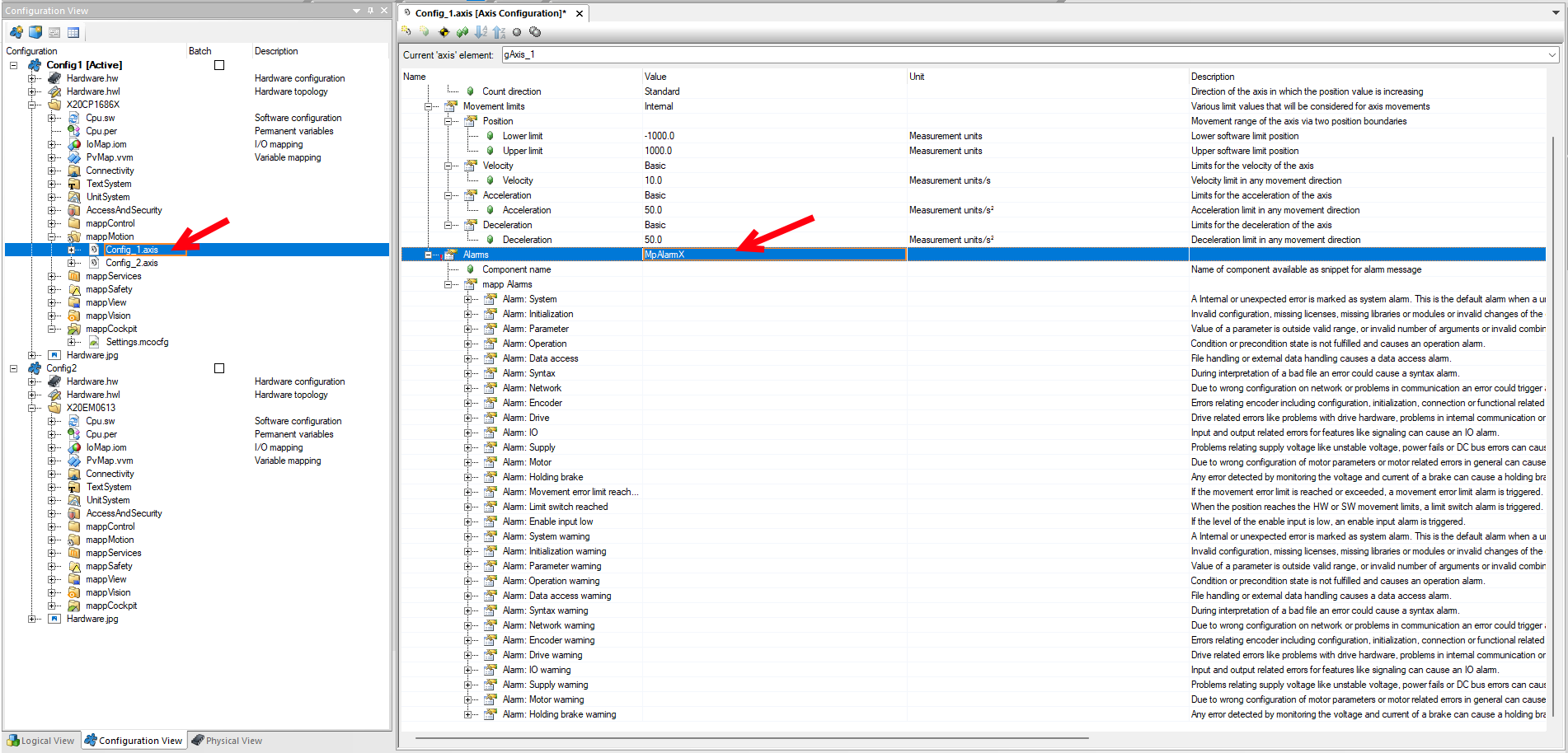

i´m new at AS6.3 and migrating an old project. I replaced ACP10 with MappAxis running okay.
Now i integrated mappAlarmX with Useralarms, mapprecipe and so on. But Axisalarms are not working.
I tried to make settings as shown in Help without any succes:
In Reciped.cfg i activated Alarms:AlarmX and they are shown in AlarmCoreX
In MappAxis i did the same without any result. So i tried a Mapping in AlarmCoreX like gAxis* without succes anyway.
How is procedere to get AxisError in MappAlarm? Just simple Version wtihout Gruops, escalation etc…

Just one Hint. You wrote about migration. Did you try to delete an axis object-file and drop in a new one from the toolbox just for testing?
Update: I made a clean Testproject and took the “advance alarm system” and now it is working.

If i have an Error in Axis component, this is always an EdgeAlarm which can be acknowledged while it´s still active.
So you are not able to run axis without any alarm in Alarmlist.
Anyone has a solution/workaround for this.

About the new Question, how to work with the Edge-Alarm Setting:
I have made my Axis-Tasks to work some how like a IPhone… if someone hits a “Start”-Button i try to execute it independend of the current Status.
If there is a command for the Axis incomming i first check the Status of the Axis, if it is a Error active (MpAxisBasic.Status <> 0) then i first make a Reset. Then i try to execute the requested command for the axis. If it runs again in an error a new AlarmX Message pops up and the command will be aborted.
The Reset of the Application-Axis Alarms is independed of the User Acknowledge in AlarmX.
