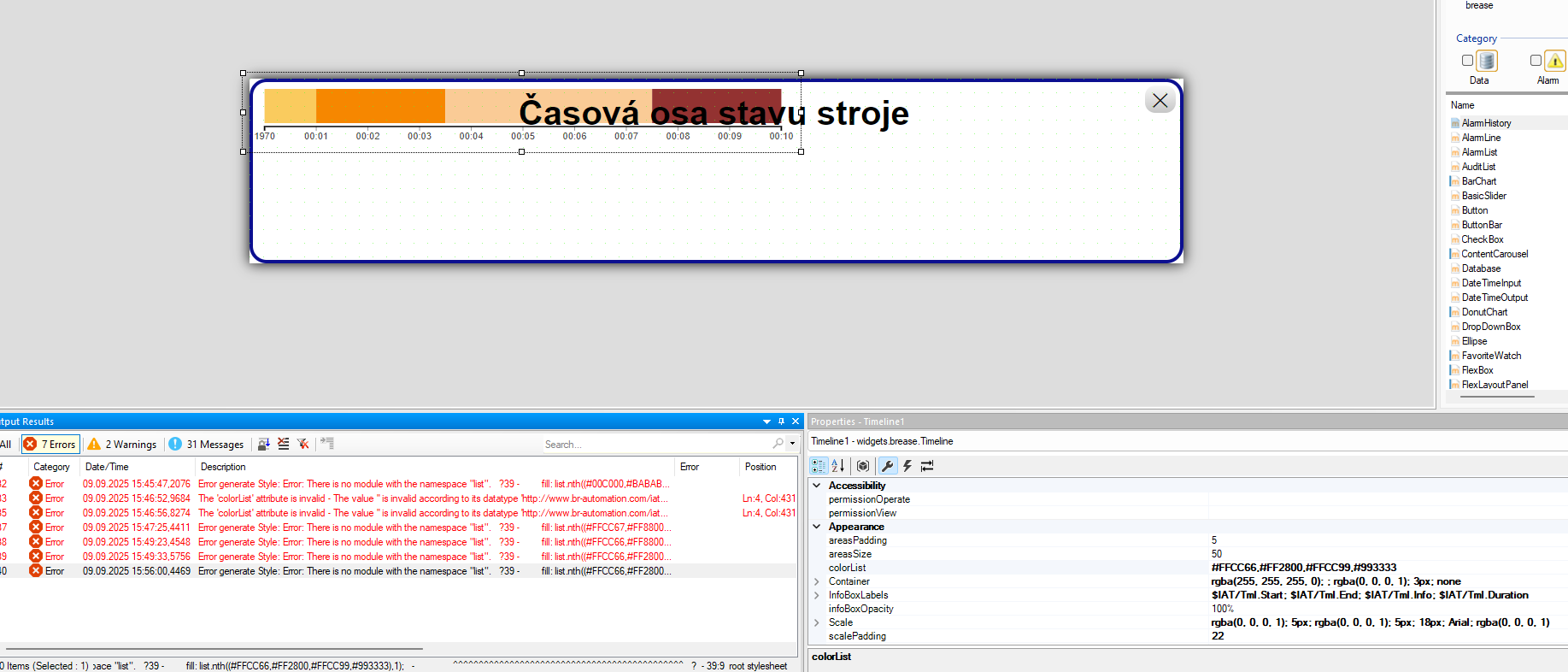

colorList in Timeline issue after AS update from 6.3.2.2 to 6.3.3.14
after update AS from version 6.3.2.2 to the newest 6.3.3.14 I have issue with Appearance colorList in Timeline.

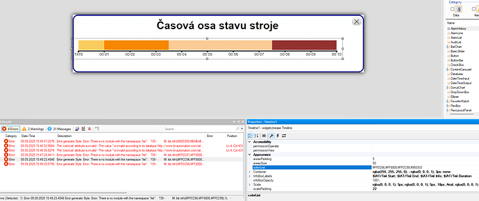

The project can be built, but when opening .content, this error appears: Error generate Style: Error: There is no module with the namespace “list”.
39 - fill: list.nth((#00C000,#BABABA,#FF0000,#993333,#000000),1);
  • 39:9 root stylesheet

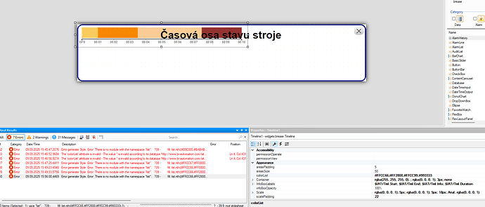

If I open .content as a text and I remove from Timeline colorList=“xxx” all is working, but if I change there at least one value, the timeline position changes (while the value in position remains the same) and an error is thrown.
I tried reinstalling AS and the same problem. Is this a bug in the AS program?
Thank you for your help.
if I change only value in property changeList I do not see any issue. Maybe open content as a XML file and check property of TimeLine widget before and after change. Usually error like that is syntax issue.
