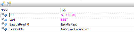

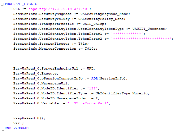

I try to set the OPC UA connection between an X20CP0483 and an External OPC server and actually got following issue “A009_0000” I would like to read the Value from the “Gross” variable and store it into VAR1.
Here is my task: (100ms)
The “Gross” variable incoming from the Server is given as a DOUBLE so I declared it as a LREAL in the Task.
The OPC link is working with UA Expert.
Do you have an idea what could be wrong with that?
Best Regards.
Hello Oliver,
Regarding the OPC UA PLCopen Status Codes, the code A009_0000 corresponds to:
PlcOpen_BadNsNotFound - 0xA0090000 - The namespace with the desired name could not be found on the server.
This means that your NamespaceUri input is not valid. Seeing your screenshot I can see that you are using the “Path” to object’s component (0:Root/0:Objects…) instead of the NamespaceUri (an example of NamespaceUri would be “urn:B&R/pv/” ). You can either use any of the following solutions:
  • Fix the NamespaceUri to the corresponding one, you can check this on UaExpert
  • Or leave the field “NamespaceUri” empty and keep the input NodeID.NamespaceIndex to 7 if this is the right NamespaceIndex for the node
Any of this solutions should fix the A009_0000 error, keep in mind that this is a standard OPC UA code. I recommend you to take a look to the descriptions of the codes they are really helpful.
B&R Online Help - OPC UA Status numbers
Hi Javier,
Thank you for your reply. I fixed this by removing the NamespaceUri and using only the Namespaceindex. I just had to change the IdentifierType to “UAIdentifierType_Numeric” an then it worked fine.
Best Regards,
Olivier Lehné
