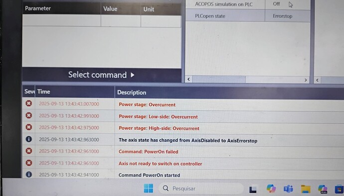

Hello. I’m having issues when enabling the power-on of the power supply 8BVP0220HW00.000-1.
When the power supply is installed in the machine, it works normally. However, when I take it to the bench, it shows a fault. The issue seems to be related to a programming error, but I’m not sure what is missing.
find the description to the errors in online help, pls.
ACOPOS error 6052
ACOPOS error 6053
ACOPOS error 6054
in case of 8BVP the ‘motor’ is the mains. Did you use choke and filter at your bench, too ?
