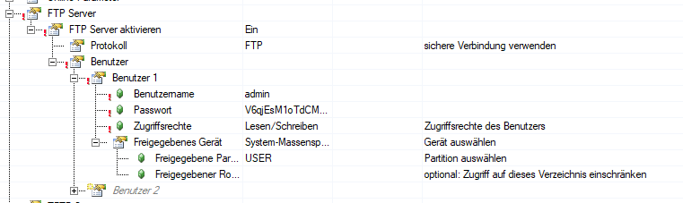

I am using this configuration:

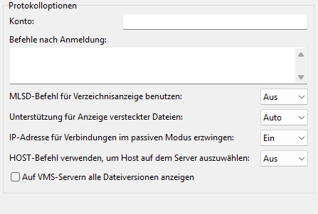

And I am using this WinSCP configuration:
This configuration used to work in previous AR Versions.
I am getting this error message:
Any Ideas?
Check the “Module system on target” section of the CPU configuration. Is there a minimum user partition size greater than zero configured? I remember running into a similar issue a while back and that was the solution.
It also doesn’t hurt to try re-entering the password you want to use into the FTP configuration and rebuilding the project.
Thanks Marcus,
have done that:
and reentered the password. Did not change anything.
Maybe important: I can see the FTP content for a fraction of a second until it times out.

It looks like there is an update related to the FTP server in AR P4.93:
It says that it is now possible to change the FTP port, but I’m having trouble finding the setting that actually does this in AS.

I don’t know why it would make a difference, but you could also try a different FTP program. I use FileZilla and the connection has always worked for me with default settings. I’ve never used WinSCP but there is a Help article which shows the needed WinSCP settings. These differ slightly from your screenshot, but if it’s worked before, I’m not sure if changing those would make a difference:

FileZilla works, but WinSCP does not. I have tested all combination of WinSCP setting, including the one which is described in the help file.

Hi Gerald,
I got some clarification that the AS setting for changing the FTP port will not be available until AS version 4.12.9 which is not yet released. However, you can currently change the port using the new AsARCfg library function blocks (CfgSetFTPServerPort and CfgGetFTPServerPort).
I’m not sure what has changed that makes WinSCP no longer work. It sounds like you have two available workarounds:
