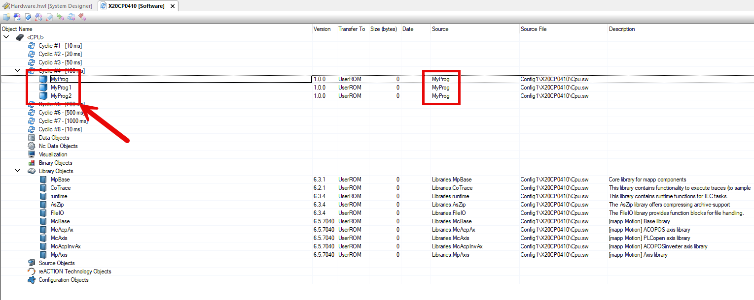

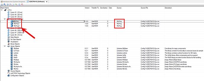

FUB for getting the name of the task instance
I am looking for a FUB to get the name of the task instance, for example in MyProg1 or MyProg2, which are all from the same source.
Yannick, I believe the FB ST_name can be of use for you, here more information
All of you have to do is to set the iden to 0
like this
