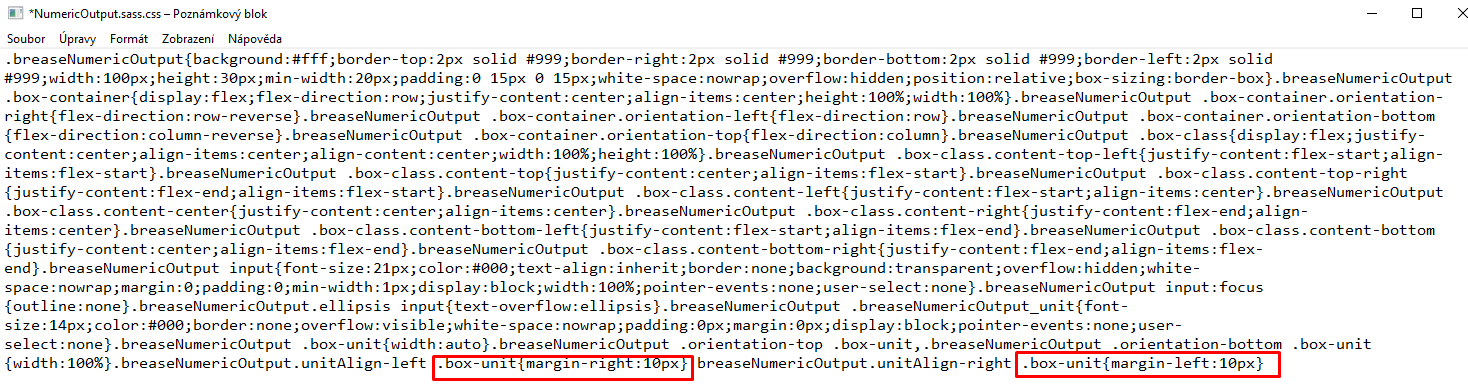

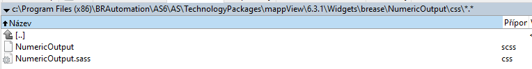

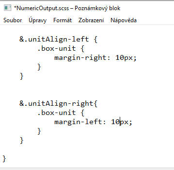

I have the same problem. A simple solution is to edit the mappView source code. For each version you are using.
Hopefully, in the next version of mappView, this meaningless value (10 px) will be reduced…
