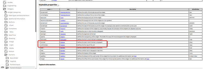

I think you are looking for property unitFontSize, aren’t you? B&R Online Help

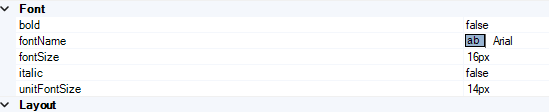

Should be in this section (taken from my AS 4.11, MpView 5.24)
I think most users like the way that they can use different font sizes for value and unit. it is a styleable property, so you can defines more styles and change it if need it :slight_smile:
