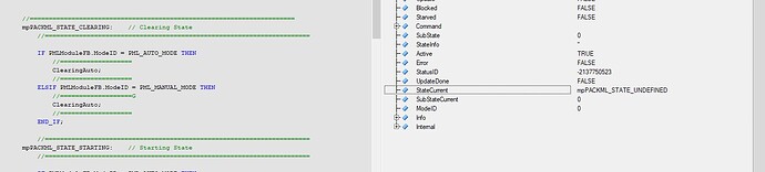

I am new to MpPackml. I have 2 stations. I added a master Mppackml, a Mpcore and 2 slaves. I connected my slave station to the master station. My master station will control the slave. I added 3 software programs to the program. 1 for the master and 2 for the slave. My master starts in mpPACKML_STATE_STOPPED and when I reset it stays in mpPACKML_STATE_STOPPING. My slave stations stay in mpPACKML_STATE_UNDEFINED. I don’t know why this is happening, is there an example?

In the submodules, it is stopped at first but when I give a reset it goes to stopping and shows the same number error. -2137750523

As for why child-modules stay in mpPACKML_STATE_UNDEFINED (based on your last comment I am not sure if you have already solved this now):
  • Does your “Parent” module display that it has 2 children? Info.ChildCount
  • Do your “Child” modules display the correct parent? Info.Parent.Name
  • Which Module activation have you set in your parent and child configurations?
As for the warning -2137750523 (Command not permitted):
  • Usually child modules are not allowed to perform certain commands.
  • In a PackML hierarchy, most commands (like Reset) are given from the parent, the child modules are notified automatically in the background and will attempt to “follow”
    • You can read up on how the communication between modules works here
  • If you have given this command on the parent (and you get this warning on the parent), it may simply not be allowed based on the PackML state diagram

mpPACKML_STATE_UNDEFINED hatasını düzelttim. artık alt modüllerim mp_stop komutunda başlayıp reset verdiğimde mp_stoping komutuna geliyor. daha sonra 2137750523 hatayı alıyorum.
