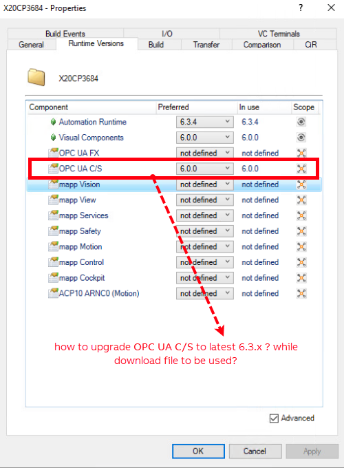

How to update OPC UA C/S version from 6.0.0 to 6.3.x version which file to download for this upgrade. Thank for your support.
Regards
Chandrasekhar RK

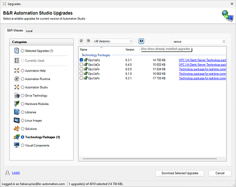

the download file is this
or in Upgrades Dialog:
Please be aware, that Technology Package OPC UA C/S 6.3 does have dependencies to Automation Studio Version >= 6.3 and Automation Runtime >= 6.3.
Make sure to update the project in case it is opened in compatibility mode.
BR Fabian
