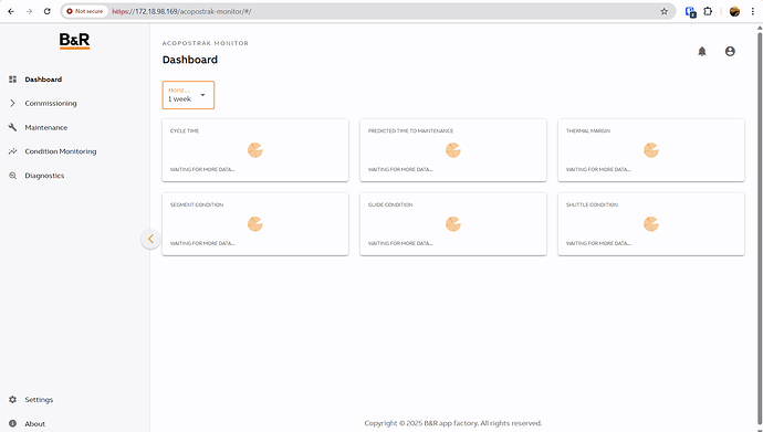

Dear All,
I installed as the topic Innovation 2025 : Industrial IIoT Connector
on 3rd-party embedded PC(x86_64) without error. I have a problem with the license registration
I tested the ArSim of the SuperTrak Distribution Package, but the saved status is disabled
I cannot do the next. Please guide me on what problem is happening to me?

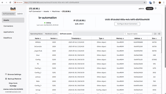

Hello @thaold ,
please proceed as below:
codemeter container is part of the IIoT Connector deployment, there’s no need to install it manually. It seems for some reason it’s not reachable.
You can start checking the actual container status with following command from terminal:
docker ps
If the container " iiotconnector-codemeter_license_service " STATUS is restarted since few seconds it means there is something wrong and you could check container logs.
Move to the installation folder, typically
cd /root/deployments/iiotconnector
and type following command:
docker compose logs codemeter_license_service
banfin
(Nicola Banfi)
July 30, 2025, 1:07pm
5
License activation has been fixed updating IIoT Connector to v 1.0.4
Please run following command
sudo edge-manager update iiotconnector
and then
sudo edge-manager license
thaold
(THAO, Le-Duc)
August 2, 2025, 3:03am
6
Dear Nicola,
Many thanks! I did run update and activated both IIoT connector and AcoposTrak.
