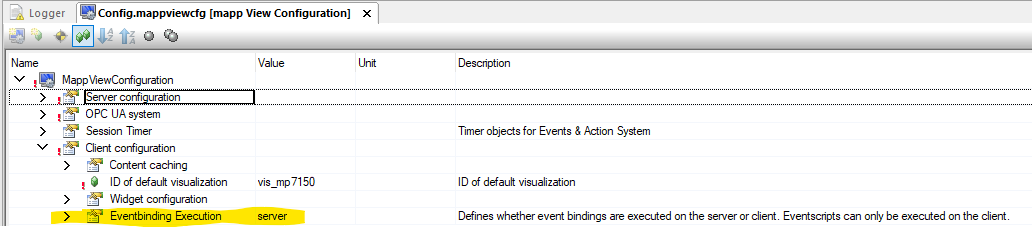

One more things what is the configuration of your “EventBinding Execution“?
event binding is at client otherwise the
Event scripts won’t work

Ok thanks for the informations, I’ve never experience the eventbinding on client side or event script :confused:
