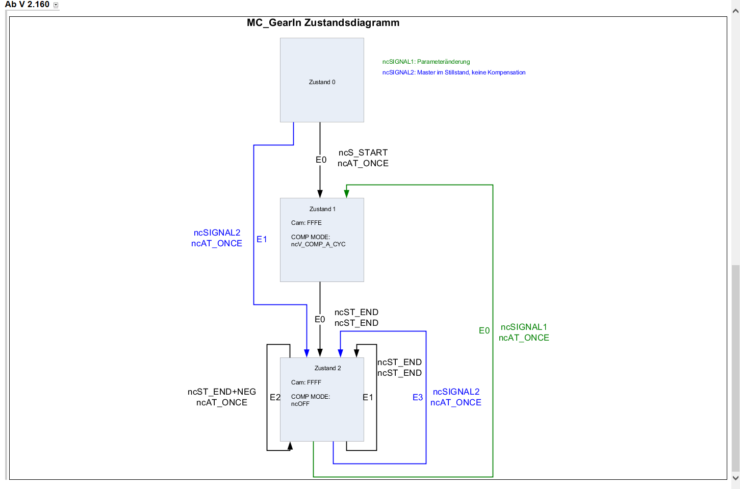

Hi Community. How do I implement the non-periodic/periodic functionality from ACP10 in the CamTableSelect function with MappMotion/MpAxisCoupling? I’m using the camlist axis feature. I have a master axis running and I want the slave to run a defined cam at a specific master position a single time with defined master and slave scaling values. The issue I’m having is I can’t seem to prevent the slave from always restarting the cam again automatically after it is finished.

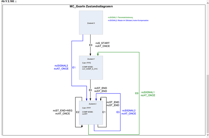

Picture of CAM-Automat for GearIn ACP10 - since 2.16.

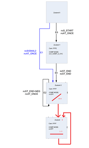

I would think you should use a full CAM-Automat and then add another Step (Step 3) which will flow the non periodic single run CAM (Step2). In Step 3 you would not have a Slave Movement and then stay there forever.

Normaly if i had a non-Periodic CAM i would only have moved inside the CAM forward and backward, the CAM was always little bit larger than the movement area, so i never had the situation that the CAM-Automat would have reached ncST-END.
Only with Periodic Axis i ever have reached ncST-END.
