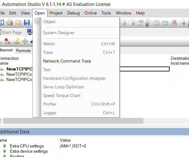

I am using Automation Studio 6.1, when I am trying open tab, which has “logger”, but the logger is disabled. BTW, I could download the logbooks as zip file. Is there any tool through which I can see these files.
I am able to open logger in SDM, but it does not give me information about how I can fetch process variables. However I could see that some of our previous attempts are logged in as vnc failed

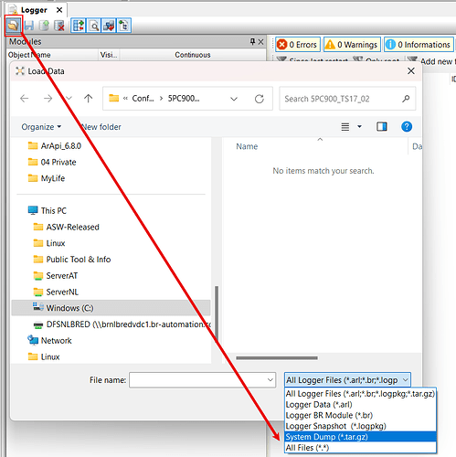

At the same time, I downloaded the systems dump and when I trying to read it from Automation studio , I am getting following message (but it does not show option of *.gz):
even if I choose any other option from file type selection I am getting following error:
Have you tried to press <Ctrl + L> to open Logger in Automation?
Then you can use “Load Data” in Logger to open your system dump file.
Logger is by default disabled, dont know how to enable it, so ctrl+l also does not work.

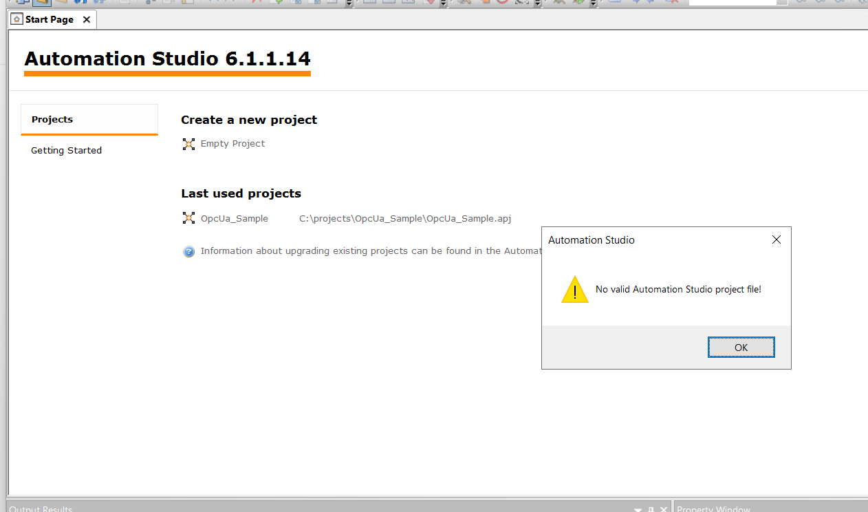

Without an open project you will not be able to open up the logger in either AS4.12 nor AS6.1
Can you please elaborate, by “Without any open project” @JulianL. This is important for us as we dont have any project, as we dont have access to the existing program running on that machine PLC.
Can you please help me understanding that if I connect my machine PLC with another B&R plc and if I create a project in second PLC, will I be able to fetch variable data of the machine PLC. If yes, can anyone please suggest the steps we need to follow
you need at least a ‘dummy’ project to enable the logger button. Don’t matter which hardware you use. Just create it by yourself following the guide.
