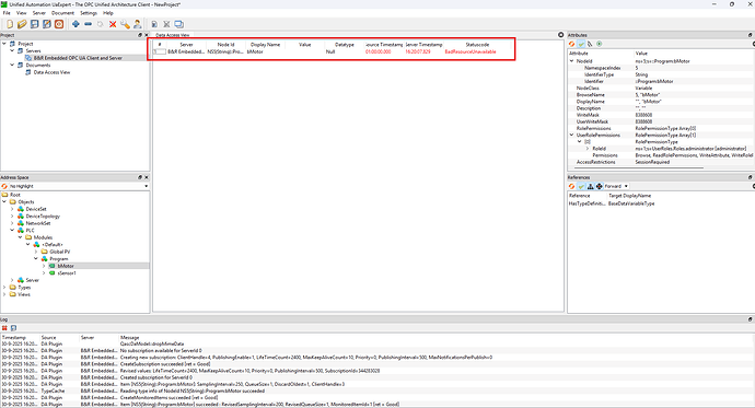

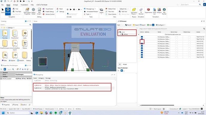

When I first start the OPC UA Server and connect from Emulate3D, everything works correctly. All variables are accessible and marked as active.
However, after making any change to the PLC code (such as modifying a value or removing a line) and transferring the project again, the OPC UA connection fails. Emulate3D shows the following messages:
  • First attempt:
    OPCUA: Item PLC.Modules..Main.(randomVariable): BadResourceUnavailable
  • Second attempt:
    OPCUA: Connection closed
UA Expert also reports BadResourceUnavailable for the affected nodes.

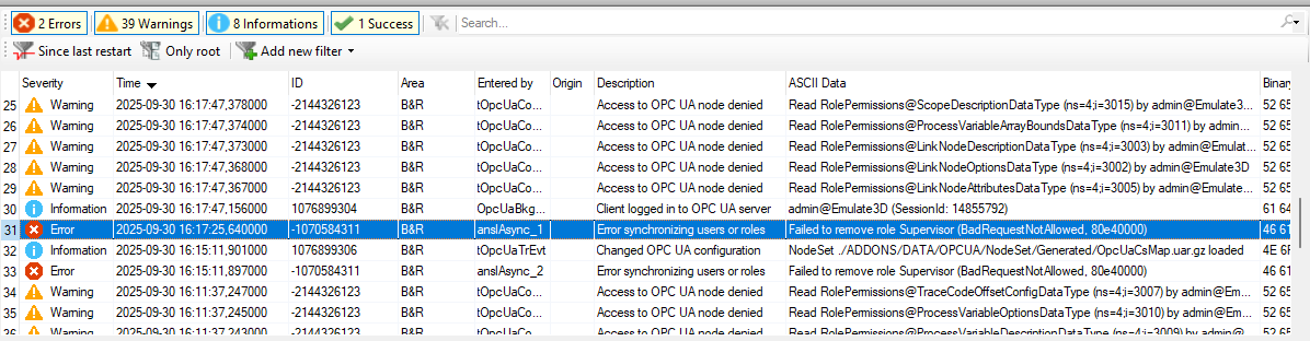

In the Automation Studio log
ger, I see the following messages:
  • Error: -1070584311 ‘Error synchronizing users or roles’ ‘Failed to remove role Supervisor (BadRequestNotAllowed, 80e40000)’
  • Warning: -2144326123 ‘Access to OPC UA node denied’
According to the documentation, restarting the PLC should resolve this issue. However, even after multiple restarts, the problem persists and reoccurs after every first transfer.

Hi @MilanON , obviously no one from the Community has an idea. Can you please get in contact with the support team at your local B&R office? And update us with solution later on?
Hi @kovarj,
I have reached out to my local support team. Should I drop the solution over here once I have one?
yes please, have a nice weekend :slight_smile:
The solution / temporary fix is to always ‘Force Reboot’ when transfering.
Now it is working fine :slight_smile:
