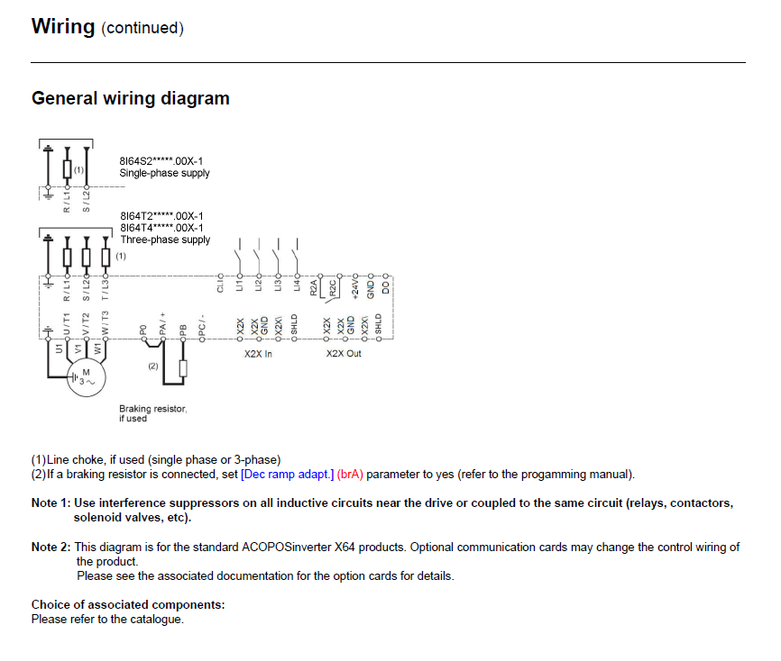

Hello:
Our customer bought one 8I64S200037.0X-000.But after powering on,this P66 can’t boot up.
Is there any problem with the wiring here?
Thank you.
i am not familiar with the device. But you might find the two manuals helpfull.
The Device “8I64S200037.0X-000” is a P64new which is basicaly an P66 with an special interface Option to have compatibility to a P64. This device is used to allow replacement and spare part handling.
I hope you can find your nessesary information in one of the documents.
There is no problem with the wiring, and the power supply voltage is also normal. At present, it can only be considered as a hardware malfunction.
