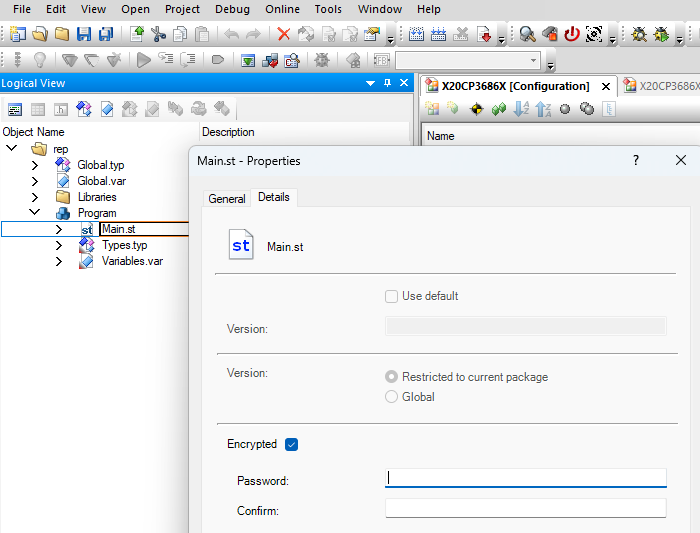

Hi, I have a project with multiple code modules (packages); is it possible to lock the access to them using passwords or maybe a user system?
you can protect a task with a password.
A whole package is imho not possible
best regards
Oliver
Hi Oliver, I’ve tried to encrypt a task but the options you showed me are grayed out; any idea why?
I’m not the original developer of this project so I’m not sure
It is important that you do not hightlight “program” (as in my screenshot) and rather hightlight the code file (“main.st” in my screenshot)
