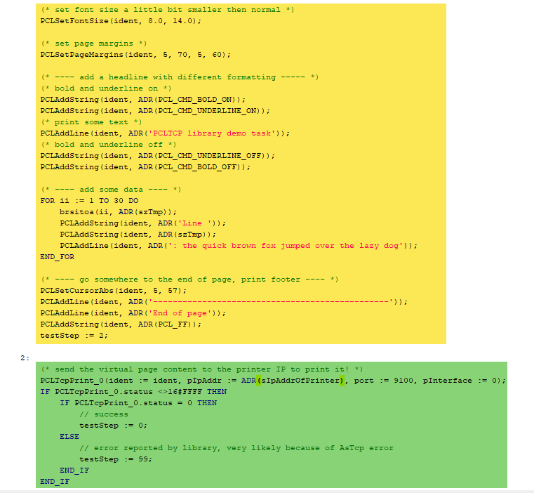

Here’s a code snippet (I left out some FB call for initialization and so on, the following snippet is part of the download package at the end of this post).
The “yellow” part is about setting up the page content and adding some lines of text, the “green” part sends the finished page to the printer:

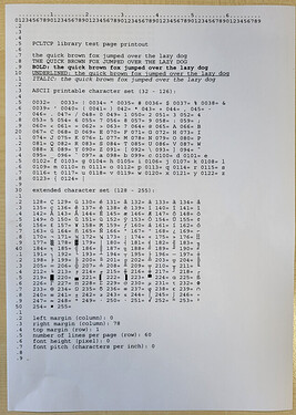

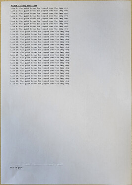

And this is what the printer prints:
Can I do a quick test to find out if my printer could be used?
If the printer meets the requirements listed above, the library has a function included to print a test page. Just setup the page, call the test function to add the test page to the virtual page memory, and send the “printjob” to the printer (same as above):
This test page includes the bold, italic, underline commands + most of the characters to check the printers font charset, and should lead to a printout looking somehow like that:
