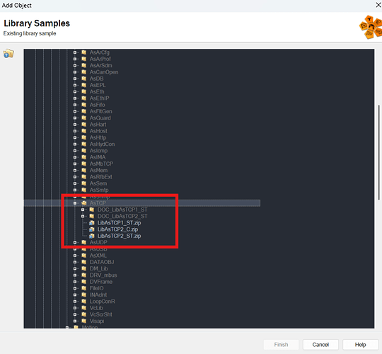

the’re samples included with the Automation Studio installation.
Just open your local Automation Help installation on your development PC, find the library help of AsTCP, and have a look into the section “examples”.

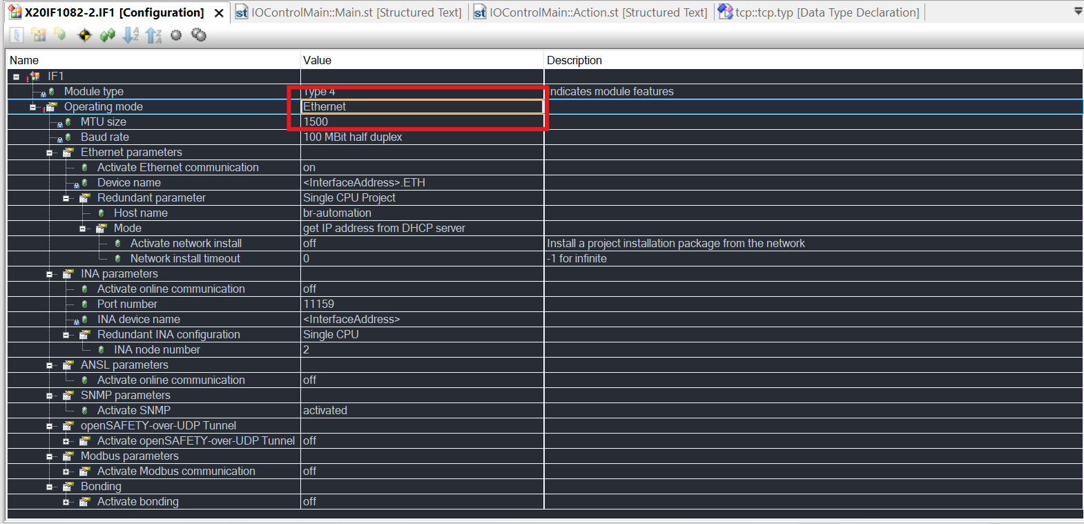

From what you described, I assume that the printer is the TCP server (“waiting for commands/data”), so the PLC has to be the TCP client (“actively open a connection and send data”).
And the X20IF module has to be set to operating mode “ethernet”, as with default setting it works as a Powerlink managing node.

  • I changed the X20IF module to be set to operating mode “ethernet.”

  • I remember locating a LibAsTCP1_ST that had a general server and client program in structured text much like a sample program but I cannot seem to allocate it to attach to my plc project.

  • Where can I locate LibAsTCP1_ST to properly attach it to my project?
Located it.
