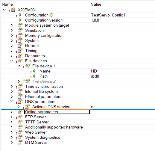

And this is the device configuration (which worked with the USB and MpBackupCore):

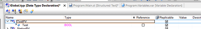

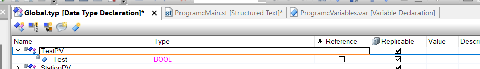

PV is declared here:

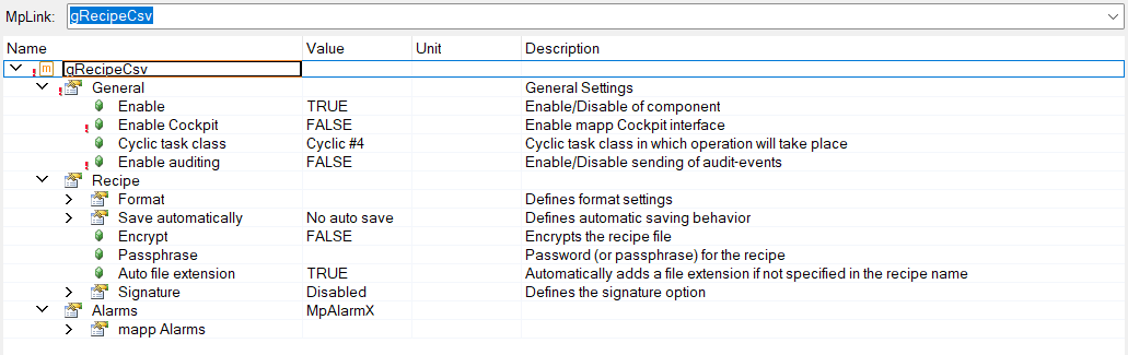

Mapp configuration:

The FileDevice could be problematic.
It is more save to use the AsUSB library to detect and find the usb-stick and resulting path, which can be different depending on the type of the USB-stick.
See earlier post: Log File in a USB Drive - Ask Questions - B&R Community
I would double check the system logbook as there might be an error if it’s trying to create the \bd0 file device at boot if nothings connected. I also highly encourage the usage of AsUSb for usb stick MSD usage.

I always recommend using the MpRecipeCsv.Active output as a conditional on the MpRecipeRegPar.Enable to make sure that the mpRecipeRegPar block doesn’t have any issue registering the parameters. Do you have any error numbers on the outputs or any messages in the logbook (mapp or Services logbook)?
