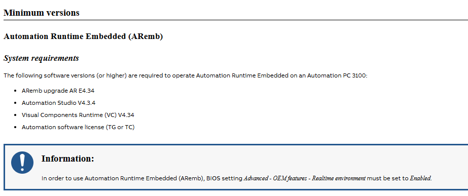

I would like to accelerate some algorithms by using SIMD which should be available for the ATOM E3940. I also found the corresponding C header files in Automation Studio. But the option SSE is disabled. Has anyone experience with this?
I don’t have experience on this particular topic, but I do know certain bios features need to be disabled for deterministic real-time predictability. It’s possible these are disabled due to this reasoning as well.
Thanks for the answer. Is there any help page or documentation on that topic?
This was from the APC3100 Software section Minimum versions

yes I decided not to use SIMD because the cost of more time needed for each context switch (copy of extra 128-bit CPU register) will be higher than the benefit for my specific usecase. I implemented the FFT algorithm now without SIMD.
