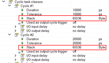

Due to changes in the font rendering library, the VISAPI functions VA_Textout and VA_wsTextout will use more stack (8k vs 20k) beginning with VC4 V6.1. This could affect existing projects which might have to increase the stack of the task class in which this functions are called.
It is a consequence of a update of the font render library for security updates and has to be taken as fact which will not likely reduce anymore
When you create a new project in AS6 the Stack size is already increased (default) to 65536 for all task classes.
