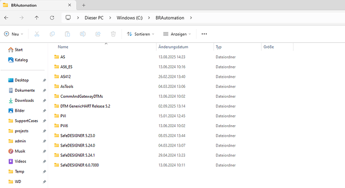

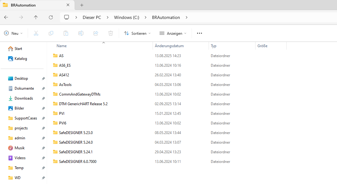

In my case, the cause was old AS files in the C:\BRAutomation folder. I removed them and ran the PowerShell installation steps again—now everything works.
@jones When you say “old AS files” what more exactly do you mean ? What files did you remove?
Hello Johan
I deleted the whole folder. there should no longer be any AS files in C:\Brautomation. I had to uninstall AS 4.12 to remove it because the German version was still installed in this path. I have no idea why there was still an AS and AS6_ES folder in there, but I was able to simply delete them.
I actually wanted to simply adjust the path asinstall in package.json, but that didn’t work.
