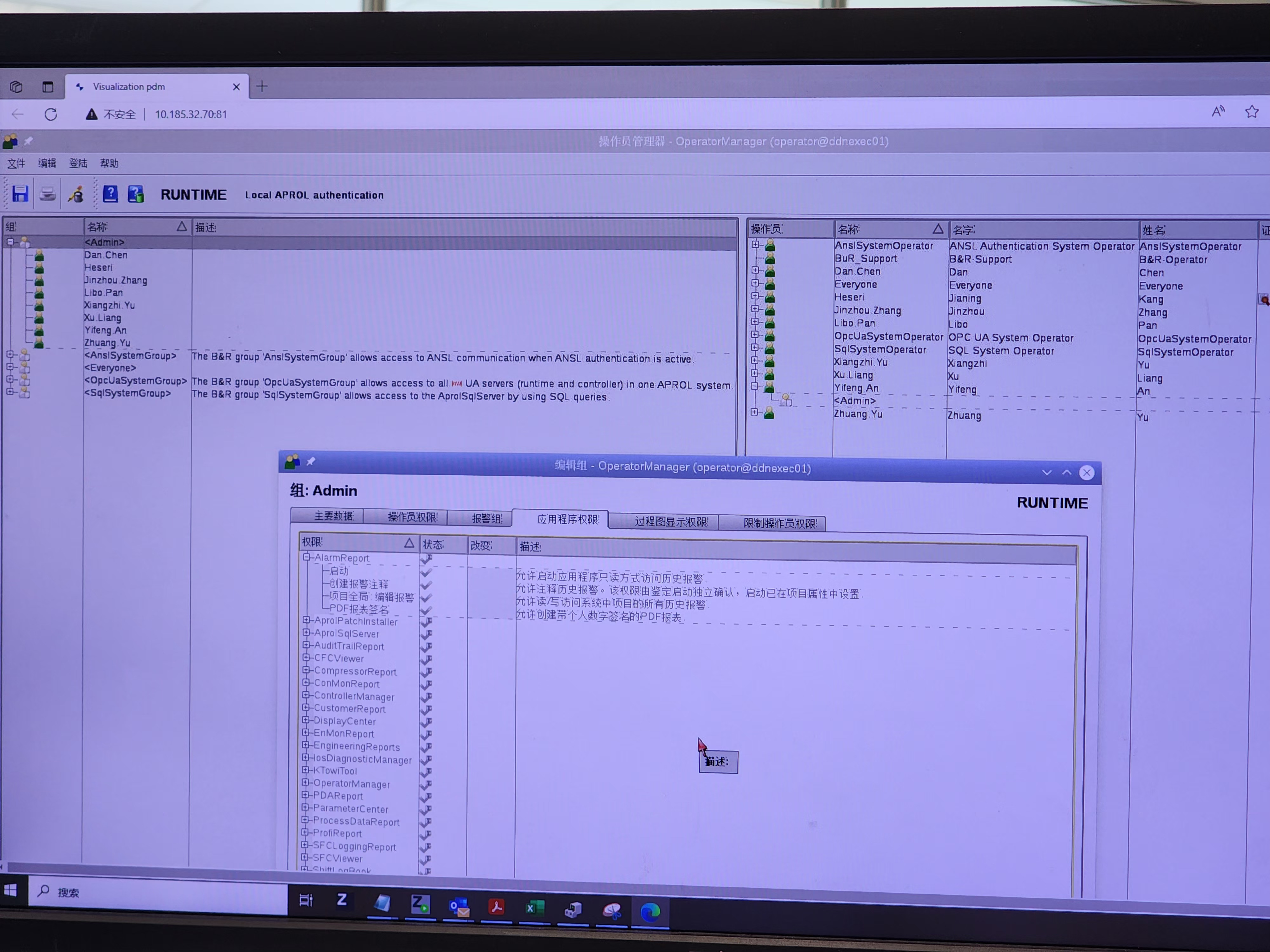

About login failure when view AlarmReport for newly created operators(OperatorSite) in APROL
The user created through the OperatorManager(In Operator Site) has normal DC permissions and application permissions, but when viewing the Alarm Report on the web interface, they cannot log in and always receive an error message indicating an incorrect account password.
What could be the possible cause of this problem?
APROL4.2-06 P11
Newly operator role;
login failed
but newly operator can execute inDC
Does anyone know why this is?
You have to create your operators in the engineering environment, perform a build and a download.
Creating a user in the operator environment only applies to this environment and therefore to the applications in this environment.
However, since web queries do not happen locally but always via cluster and/or runtime, this cannot work in this case.

I suggest that you create a global login which is only used for working with the reports. All other rights can then be revoked.
This means that the new operator in the operator environment receives a login for operating the DisplayCenter etc. and then works with the global “WebLogin” when logging in to the reports.
I hope this is sufficiently understandable.
