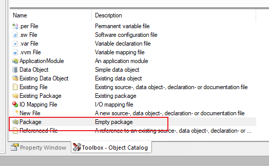

I am using AS6.3 and I cannot insert mappservices under an application module.
In the configuration and select an application module and then open the toolbox, I have only these choices
What can I do?

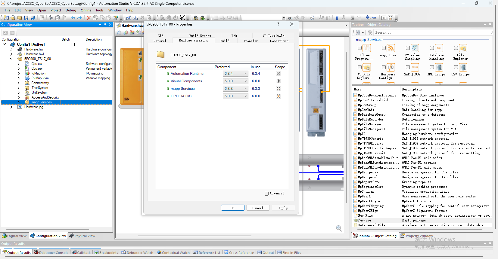

Perhaps you need to install the corresponding “mappService package”(eg.mappView/mappService/mappMotion…) first, and then they will appear in the toolsbox.
In AS6, all mapp components are not installed by default. All of them need to be downloaded and installed by yourself.
Then, this mappService package needs to be enabled
Go to projects - change runtime version - use “mappService” and click apply
Then they will appear in the toolsbox

In the new version of AS6, mappServices is not installed by default. If you haven’t installed mappServices before creating a new project, AS6 will not automatically create a mappServices-type folder in the configuration view.
  1. If you want to add the folder afterward, you can first add a folder in AS. Name it as mappServices.
  1. Then you need to navigate to the Physics folder in AS, locate your config folder, and change its folder type.
<Package SubType="mappServices" PackageType="mappServices" xmlns="http://br-automation.co.at/AS/Package">

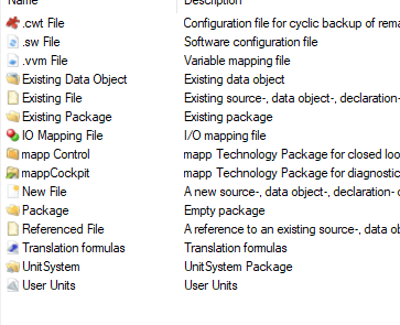

This is relevant for standard use of mappServices, but for application module? From my point of view mappService package must be on the list as e.g. mapp Control is in printscreen from AS6.
