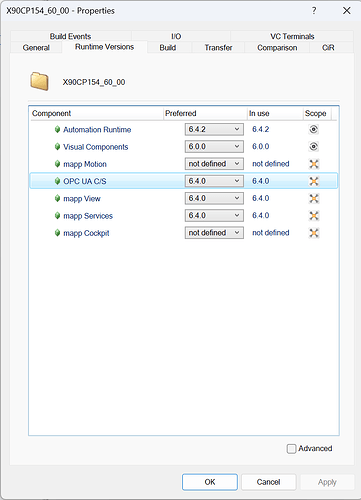

can you please post additionally the version of the opc ua technology package you’re using?

Thanks!
