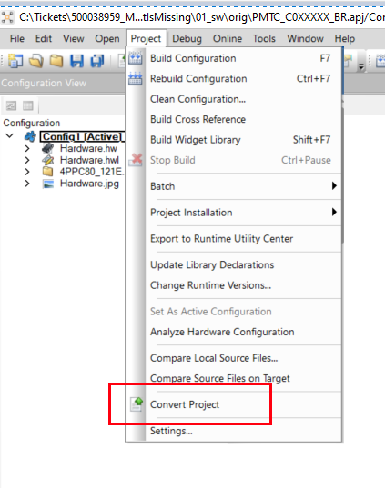

After installing new Automation Studio 6.3, I have noticed that projects developed in AS 6.1 are opened in compatibility mode 6.1.
To convert a project to 6.3, you have to go to Project → Convert Project
And accept that, after conversion, the project cannot be opened in older versions.
Maybe this finding will save some of you a couple of minutes of searching.

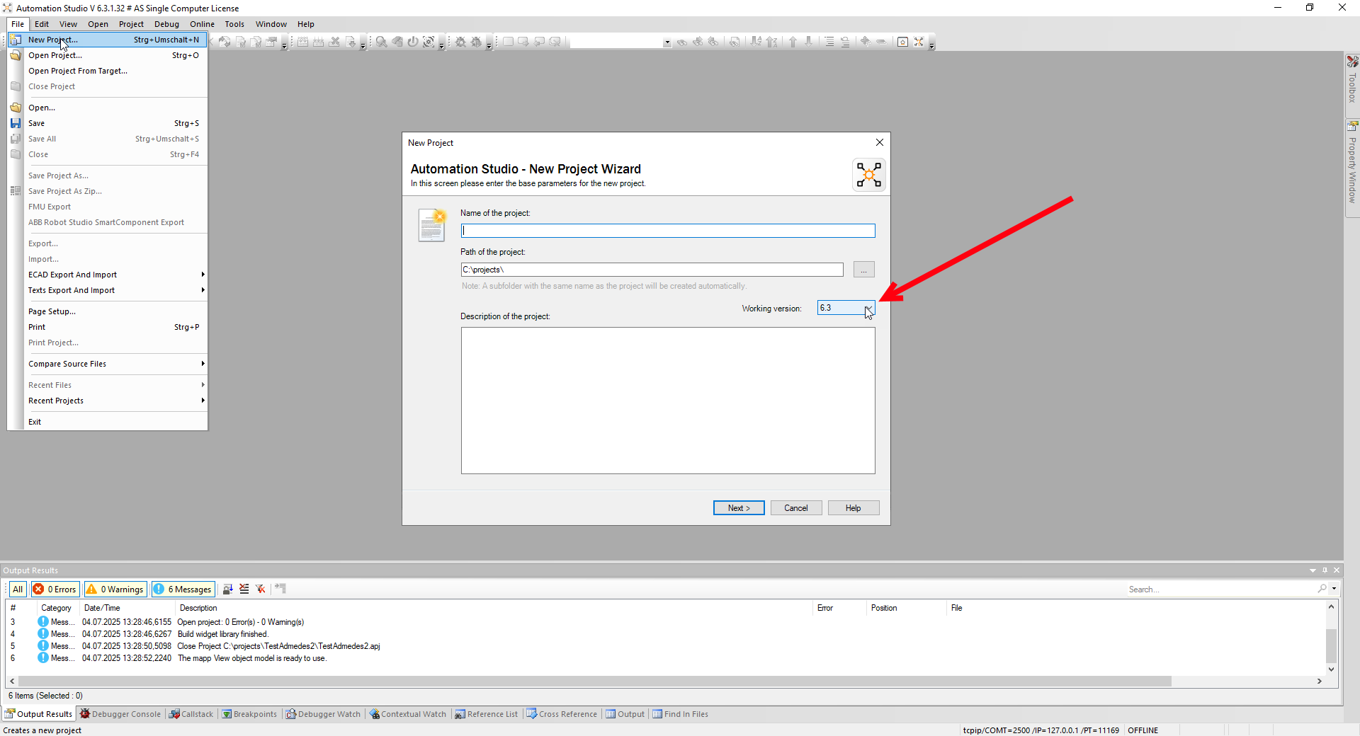

I may add how the opposing way will work, if you have Installed AS6.3 and need to create a Project for a Colleague with AS6.1. You can then use the Selection in the New-Project Wizzard to set up the Working Version.

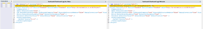

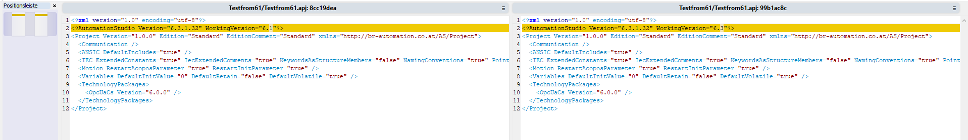

This is weird. When I tested it, I changed the parameter WorkingVersion manually in the configuration file to 6.3, and after reopening the project, it was no longer in compatible mode. Are you sure that the change from your end was really pushed and pulled by your colleague?

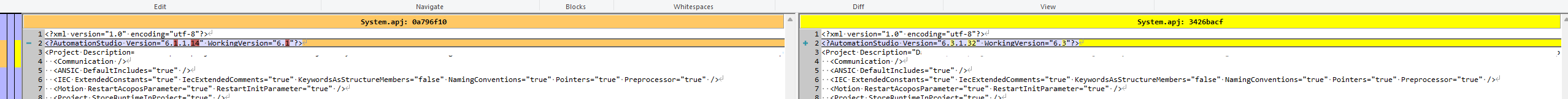

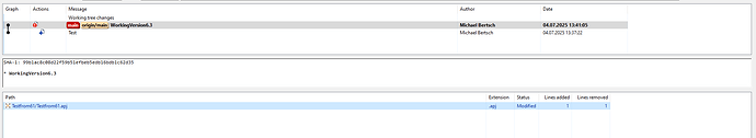

Hello i can support the findings of Jaroslav,
i had used 3 Repos. Repo_Test (Bare) ; Repo_Test_A to make the Conversion, and then Repo_Test_B to check.
Here we can see the Commit which shows only change of .apj
The second Project was opend in AS6.3 normal mode.
