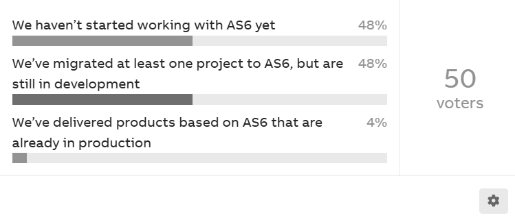

I closed the survey already a few weeks ago. Here is a printscreen in case you are not able to see the final result:
Cheers
Christoph
This makes absolutely sense, and I understand that. You must find a benefit for you to change; for one, it can be new hardware support, and for others, e.g., new Automation Studio Code. I believe the transition from AS4.12 to AS6.x and AS Code is a long-running process—and we do not speak about months, but more about years.
