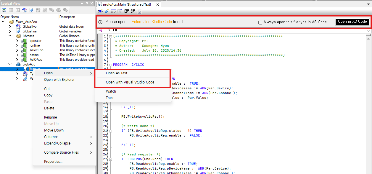

Not an Automation Studio Code, but related to…I wish there was an option to turn off the ‘Please open in Automation Studio Code to edit’ area in the code editor of Automation Studio.
I think it’s better to right-click program.st and move it through the Open as Automation Studio Code option.

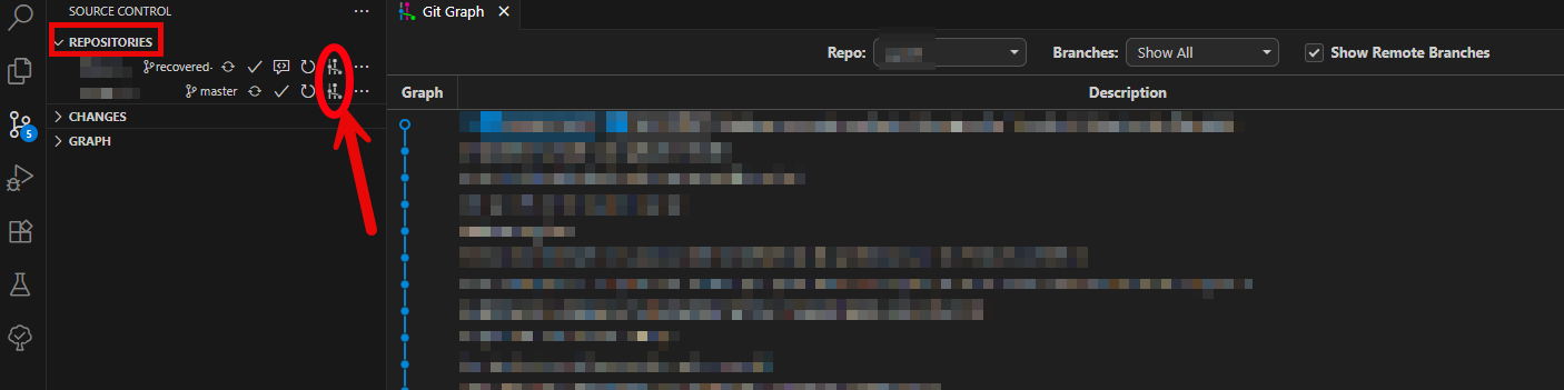

I personally really like the extension “gitgraph” in VisualStudioCode.
So I installed it in AsCode as well, but it behaves a little differently:
In VsCode It looks like this:
The new Icon appears in the “REPOSITORIES” Tab to open the Graph View of the Repository.

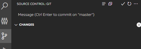

In AsCode it looks like this:
As you can see, there is no “REPOSITORIES” Tab, therefore no icon and also no “GRAPH” Tab…
Am I doing something wrong?
Is there a way to include this in future versions of AsCode?
best regards
Stefan

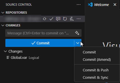

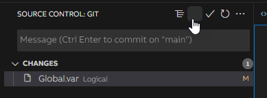

I usually use this button to open gitgraph in VS code as well as AS Code
But you are right there are some differences, also in the git integration the commit, push button are not so convenient as VSC
Please note that there is hidden button to open gitgraph here (next to the commit button)
Hi Rémi,
thanks for the tip, I did not see the invisible button :melting_face:

We are working on this. In 6.5 you will be able to hide the Open in AS Code button.
The mentioning as Open with… we also have been thinking of. Will see if that gets to be implemented or not
VSCode uses their own implementation and we are using the official git integration that is in theia. We were at first also quite surprised why it is so different. Apparently VSCode added a bunch of their own there.
But the GitGraph version on VSX should be the same as the one in VS Code
