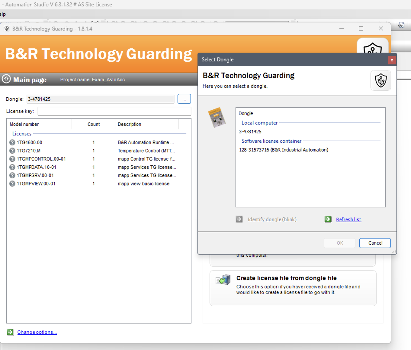

So, I test technology guarding compatibility with aarch.
  1. Technology guarding 1.8 standalone → Work
  2. Technology guarding 1.8 via Automation Studio 6.3 → Work
  3. Automation Studio Code license validation → Unable to get license information (Same on Qualcomm Snapdragon processor with not VM environment.)

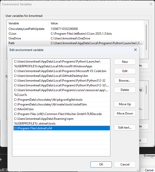

I actually had this same problem with my M2 macbook with parallels. I did find the solution though.
You’ll need to uninstall the .NET framework that came with Visual Studio (an arm64 version) and then reinstall .NET 8.0 framework x64 (I did this by downloading directly from Microsoft). You’ll need to manually add the .NET executable to your path, but after that the licensing works for AS Code as it normally would. For whatever reason, even if both .NET frameworks (arm64 and x64) are installed, AS Code will default to the arm64 even though it requires the x64.
Hope this helps!
Does this mean adding system environment variables? (DOTNET_HOST_PATH)
If this is not the case, I would appreciate it if you could let me know. (I’m not friendly with .net)

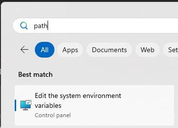

Yes, you’ll need to add the directory with the dotnet executable to your PATH
search for path
got to “Environment Variables”
choose variable “PATH”, edit it and add the new directory “C:\Program Files\dotnet\x64”
