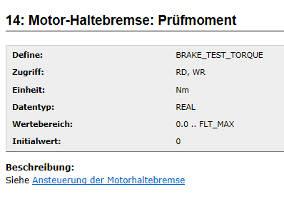

Due to this documentation i would think its the BrakeTestTorque which defines the direction. But i never made a Brake Test.
Brake Test Description
Hello
Only a positive Value is allowed for the BrakeTestTorque. in the documentation i can only find this “The test torque direction is not defined for axes without a load.” but the MC_BR_BrakeControl has no input value for a load.
Thanks for bringing up the limitation of the input, i did not checked the ParID info, you are correct.

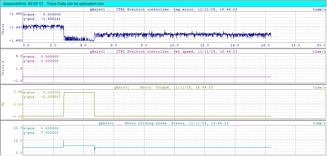

i used now a Testmotor and the Result looked like this.
First Test with TORQUE_ACT at start negative - Test Torque was applied positive

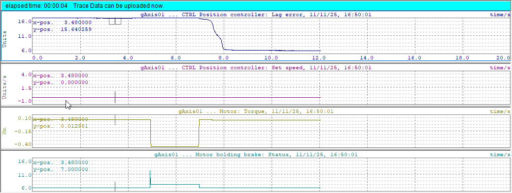

Second Test with TORQUE_ACT positive - Test Torque was applied negative

i used the Motion-Testwindow Motion-Trace to Trace the ParID 277 - TORQUE_ACT.
The only Program Code is shown in the post above.
All other Commands where executed in Motion-Testwindow.
