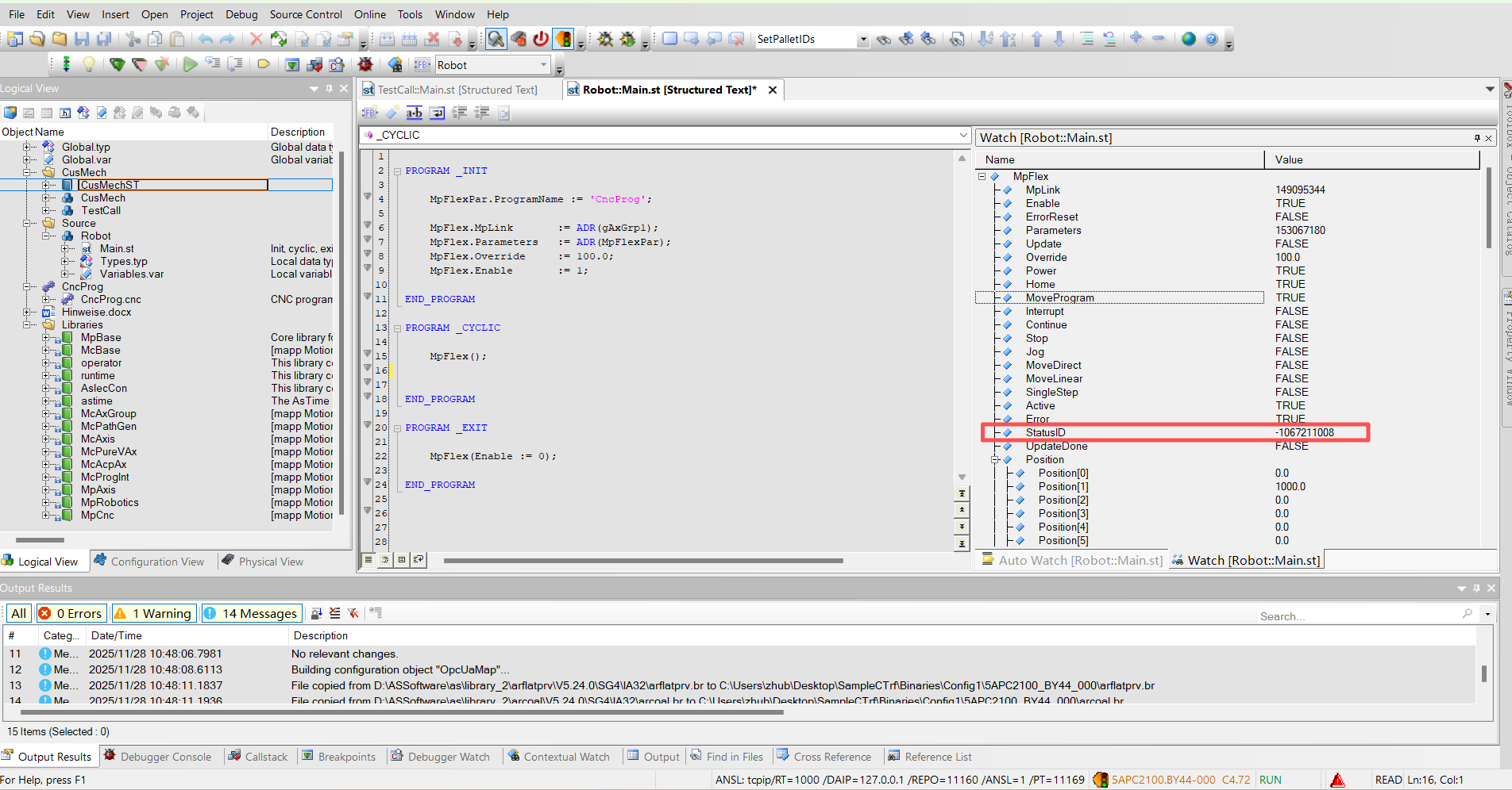

HI Michael Bertsch.
I have used your programme Power and Home without issue, but when I click MoveProgram, the programme throws an error. I have not modified your programme. Do you know why this might be?
Can you open the logger and check the motion logger from boot up. I think there schould be an additional Information about which value in the settings is the one making the problem.
Can you in general check all values with exclamation marks in the axes group settingsfile. The exclamation mark means that the differ from the standard value, this is in general not an issue but i think one of these values seam to be out side of range.
