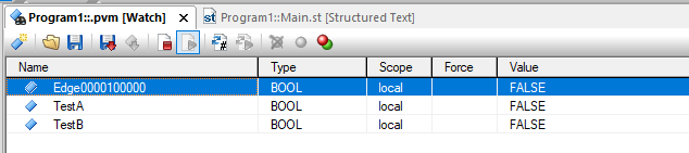

Just to have some pictures…
In the Watch Window you can see the automaticaly added “Edge-Memory” Edge0000100000.
You can think of a code linke which is implizit hidden behind EDGEPOS, which updates the “Edge-Memory”
If you use EDGEPOS in cyclic content it will work correct. But if you put it inside some conditions, it can happen that the edge-Memory is not updated in a correct way.
Here the code to evaluate a Edge by yourself. With this code you can place the Memory-Update to the correct cyclic context.
IF EdgeValue = 1 and EdgeValueOld = 0 THEN
// EdgePositive detected
END_IF
EdgeValueOld := EdgeValue;
