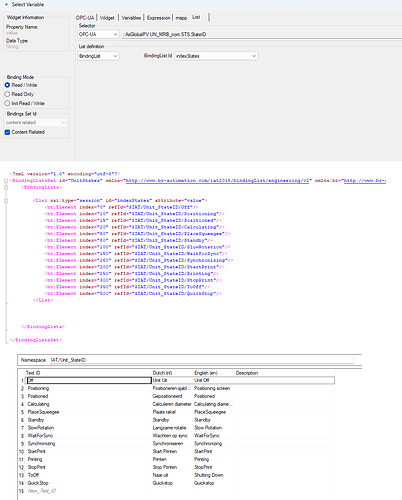

For whatever reason, Mappview lacks an easy way to show my machine state dynamically by the use of a text list. Simplified, when my case step changes, the number is used to trigger a text in a textoutput field. When the case changes to another number again, another text is shown in the same text output. I could do this by writing a different string value to a string variable every time, but then its not translatable, so I need a localizable text list
When I’m binding a text output, it shows me a tab called “List” where I am able to bind a OPC-UA selector and a binding list. This seems to be the way I need, but I can’t get it to work. When I ask B&R they use another method using snippets, but that’s another dead end as well, simply because I lack the xml knowledge and the way things communicate.
Would someone be willing to explain to me in detail how to accomplish this?
I have a localized text file with my states in it and I use an integer (or actually Enum) which should trigger these texts into an text output.
In the images I hope you can find what I am trying to accomplish with these binding lists. (Sorry, new user can only put 1 image).
Thanks in advance!
Hi Patrick,
this way I think you can also achieve the goal. I guess the reason why it is not working now is that $IAT/… is not a valid element here.
You can try creating two (just to try it) session variables to store the full identifiers of the text.
Here is how it could look like:
create a list having these elements
<List xsi:type="session" id="List1" attribute="value">
  <bt:Element index="0" refId="state0" />
  <bt:Element index="1" refId="state1" />
  <bt:Default refId="state_undefined" />
</List>
and session variable file with these variables:
<?xml version="1.0" encoding="utf-8"?>
<VariablesSet id="setID" xmlns:xsi="http://www.w3.org/2001/XMLSchema-instance"
         xmlns="http://www.br-automation.com/iat2015/session/engineering/v1">
  <Variables>
    <Variable name="state0" xsi:type="ANY_STRING" value="$IAT/Unit_StateID/Off" />
    <Variable name="state1" xsi:type="ANY_STRING" value="$IAT/Unit_StateID/Positioning" />
    <Variable name="state_undefined" xsi:type="ANY_STRING" value="Not yet defined" />
  </Variables>
</VariablesSet>
With this approach you can get also some default text for the case you will add more states in future without breaking the text system at the widget.
Other option would be to use the snippet (but you already know).
I hope I do not have a typo there. I did not compile it. Let me know if that approach is working for you.
Tom
Tomas - Two words - Absolutely perfect!
Thank you very much, that was exactly what I was looking for, session variables.
Fixed it and learned something new today! Thanks again
