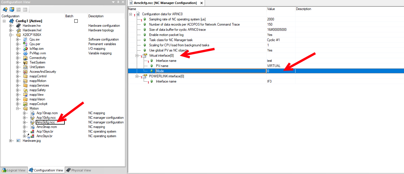

My guess is that you have a very “old” virtual interface in your Configuration.
And this Virtual Interface has a Configuration called “Mode”.
I hope this goes in the right direction. Please have a look in the file in your Automation Studio Project.
no i don’t think it is usefull to add it, because in modern days we don’t use it anymore.

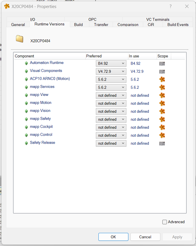

- Which versions do you use “Change Runtime Window screenshot?”

- Here are the Change Runtime Window:

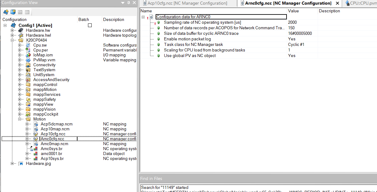

I could now reproduce the error in my local test project. It started to occure after removing CNC_Enabled=“1” from all ACP10 Axis. So there is no Axis the ARNC0 could use.
The ARNC0 is telling us that on his interface he could not find a “node” = “axis” which is enabled for CNC-Operation.
The error vanished if i disable all ARNC0 channels.
- Can you please check your ARNC0mapping?
- Do you use a CNC-System on this PLC?

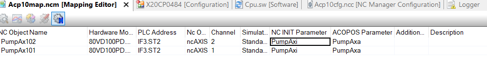

These are the ACP10 mappings. I meant the ARNC0 mapping.
Arnc0map.ncm
Do you have this file?
