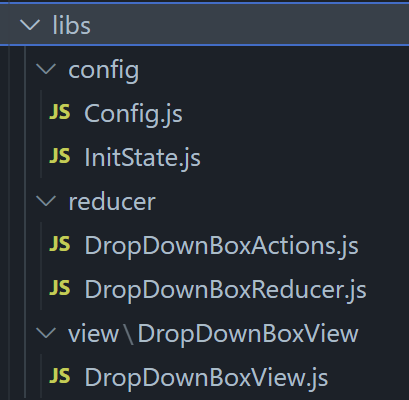

We need to copy the file DropDownBoxView.js and all its dependencies into our widget folder. In total we need to copy these 5 files from the original widget into our own widget folder.
The files that we just copied use dependencies that do no longer work when the files are not in their original location. The references point into the widget brease framework that we can not reach from our widget library. This means that we need to modify these references. Our first goal is to fix these references and make the code work as it is.

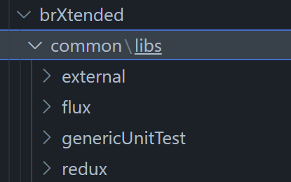

The function references several items from “widgets/brease/common/libs”. Unfortunately, the API does not allow access to all components in this path. You will see later on that there are more references to the common path. Instead of copying one file at a time, we take the complete “libs” folder and make a copy in our widget library in our own “common” folder. This has the advantage that we can use this common folder in the future without picking every single file again.
:information_source: Keep in mind that this common folder could change in the future with another mappView version at which point you have to repeat the process again.
The result should look like this:

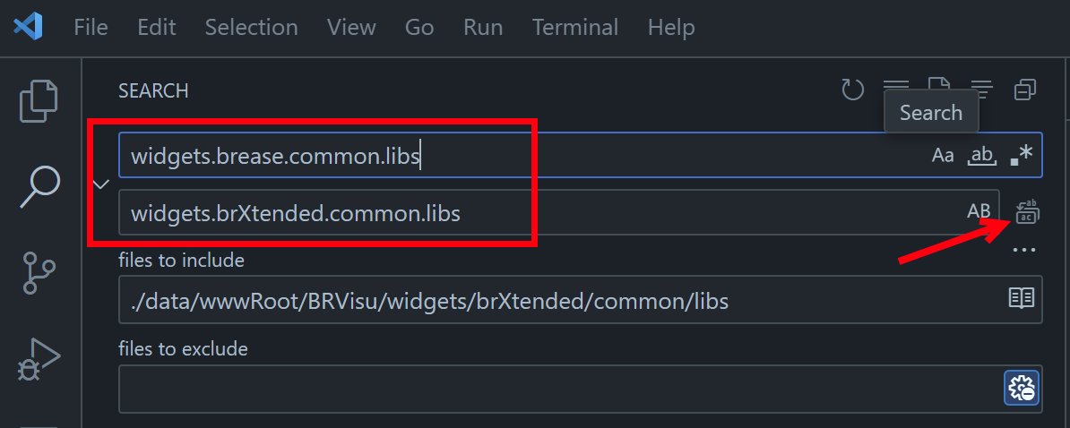

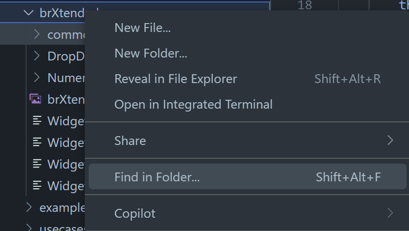

The common folder that we just copied has tons of references to the brease framework that we need to modify. Right click on your “common/libs” folder and select “Find in folder”
Enter the following text and hit the replace all button
Repeat the same with this text and hit the replace all button
With a little bit of luck, everything in libs should now point to our common library. We can now go ahead and modify the references in the DropDownBoxView.js file from “brease” to brXtended" to point to our library.
