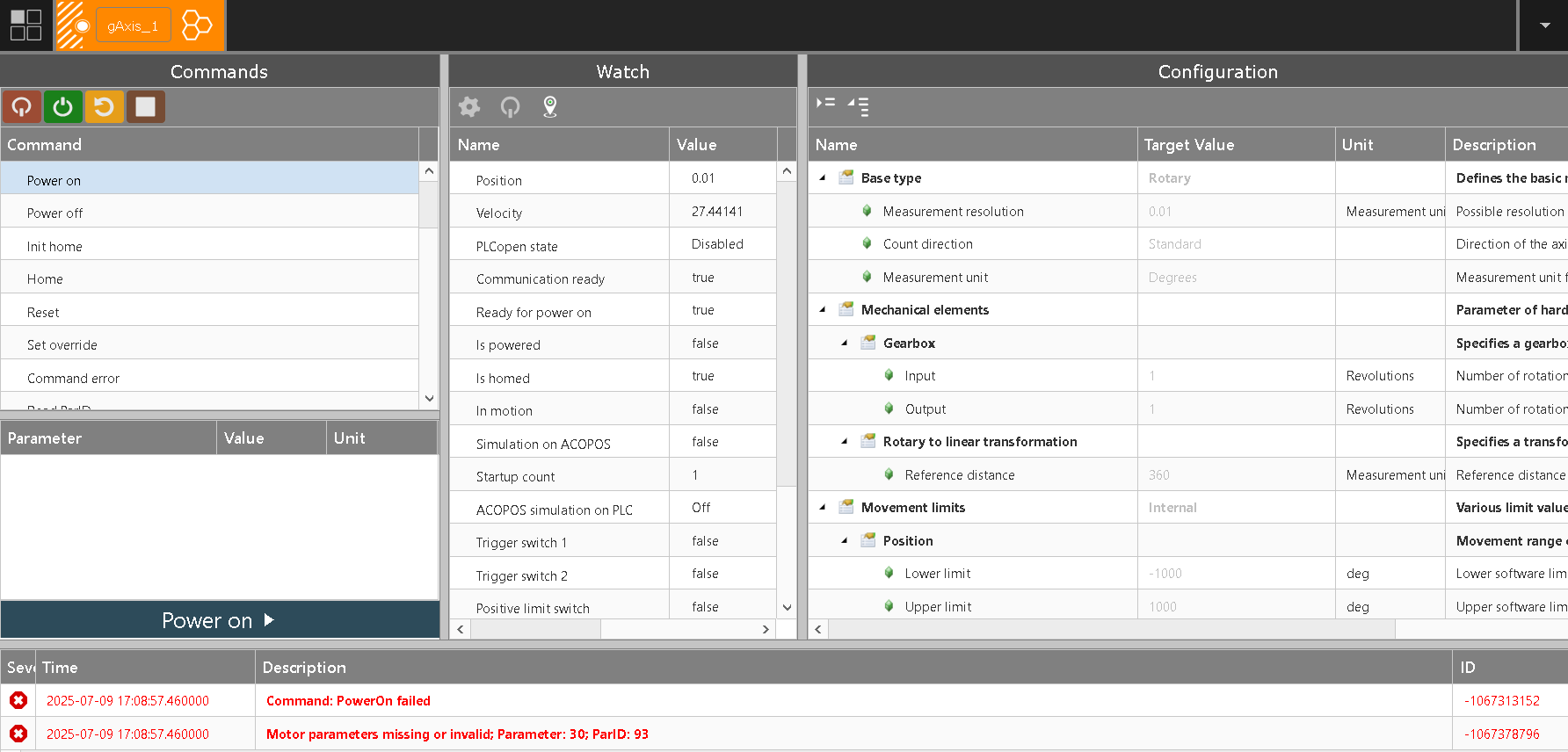

mappMotion using P3 meet error -1067378796 (Power on failed)
I can not power on the motor on cockpit, I think the configuration is OK.
Please help me check that , thanks!

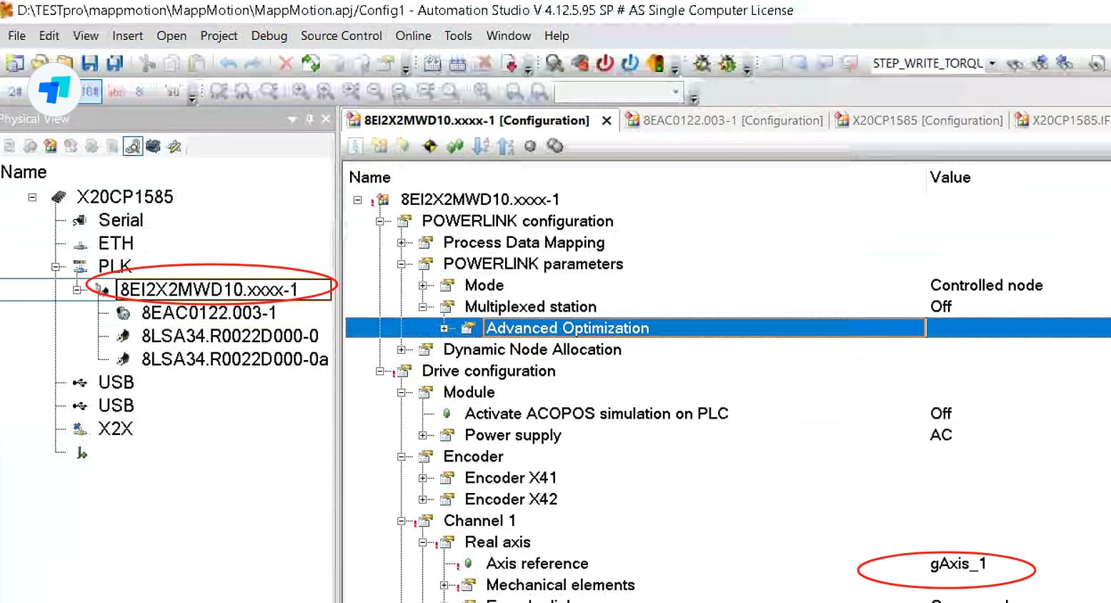

Have you linked your axis encoder to the option board you inserted in the drive?
This is not clear from the screenshots.

This is the nct/drive log and Encoder config, it seems the motor parameter does not configured.
But the motor parameter should load automatically I think.

Hello Jan,
We tried this:
  1. Manually write the motor parameters into the parameter table A34R0_2200.apt.
  2. Add Config_3.axisfeature (Feature_AcpParTable) in mappmotion.
  3. Call A34R0_2200.apt in Feature_AcpParTable.
  4. Call Feature_AcpParTable in the channel characteristics of the servo.
We use these steps and now it works well.
