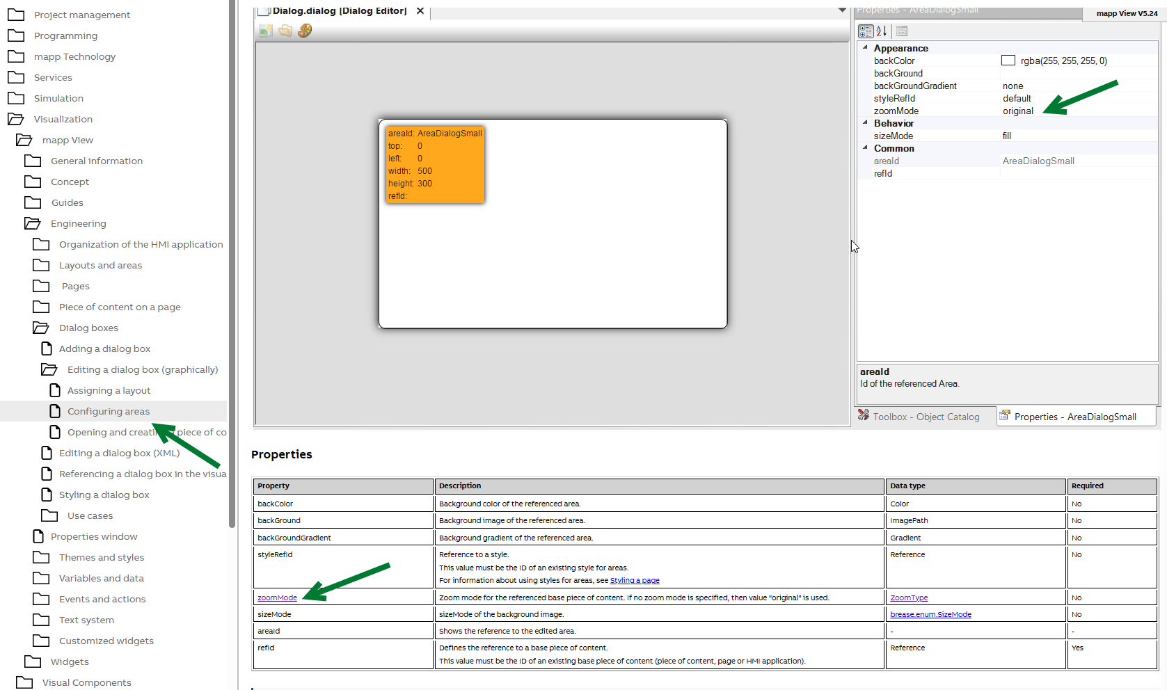

If you configure areas for a dialog, you can specify the zoomMode.
I haven’t tried it, but if I understand the description correctly, and all jog contents will have the same aspect ratio by configuring the zoomMode to cover, it should work as you want.
Hi Pavel,
Thanks for this input. But I would like to have it the other way around.
Not that the content is adjusted to the size of the dialog, instead the dialog should adjust itself to the size of the loaded content.
