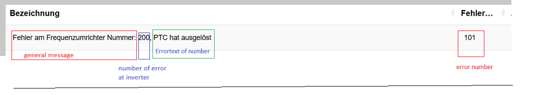

I put here a small summary what i want and how to solve
I want a errormessage of an inverter with number an errortext of the inverter in one errormessage
It looks like
The language can be changed

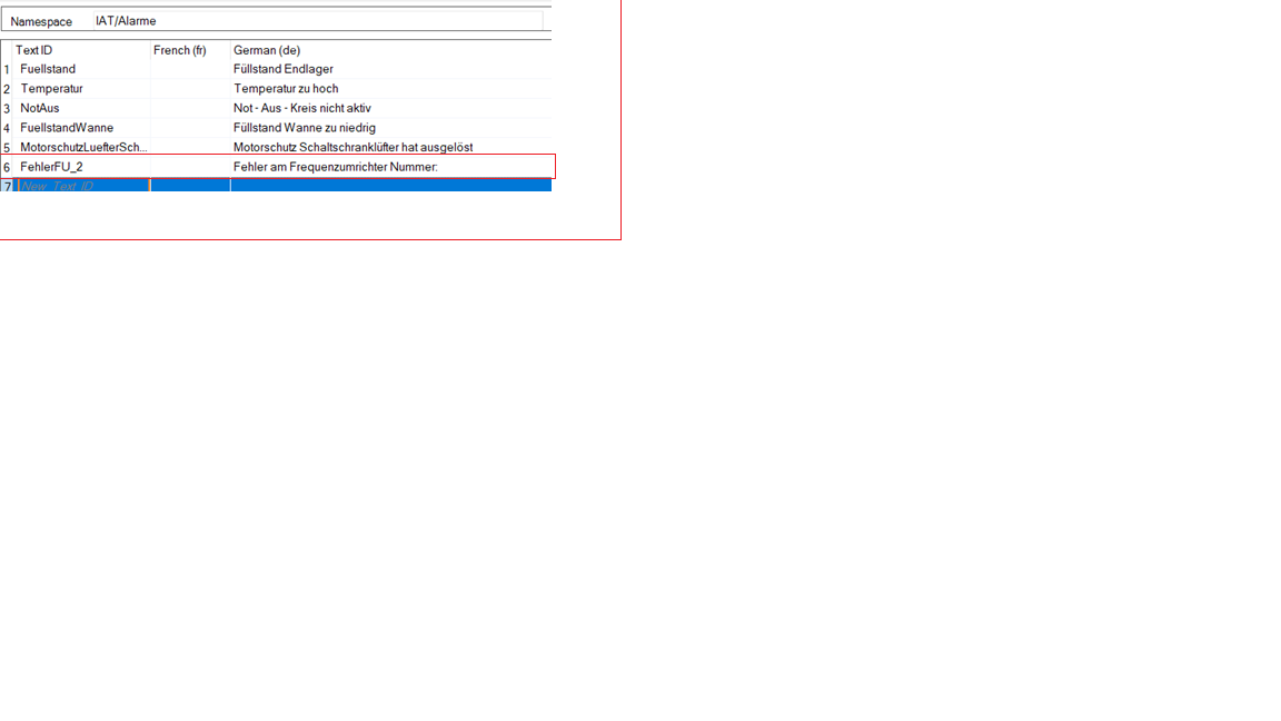

  1. Create a new alarmlist item
  2. Create a localised textgroup for the alarmtext (here: IAT/Alarme)
  3. Create a localised textgroup for the text used by the snipped (here: IAT/Fehler_FU)

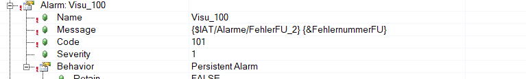

  4. Create a snipped inside the alarmsystem. The pv visual:ulFehlernummer2 is the index of the errorcode of inverter
  5. Combine:
    The complete string is “{$IAT/Alarme/FehlerFU_2} {&FehlernummerFU}, {=$IAT/FehlerFU/{&FehlernummerFU}}”
In this case the snipped is first used as a number: {&FehlernummerFU}
and after to choose the textitem in the textgroup “FehlerFU”: {=$IAT/FehlerFU/{&FehlernummerFU}}
In order to get the text of the textgroup by snipping index you need the figure “=” in front.
Notice: I didn´t find a way to resolve “standard” snippets in localised textgroups which are use in the alarm system. You will get ?Nul.
