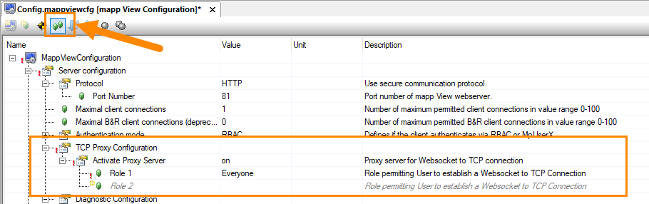

AS4.12 and PPC2100,
Added features to old controller and keep partially original VC4 added featured made to MappView, willing to show old VC4 screens also on mappview, but cant open.
old PPC2100 not support hypervisor

Can you please share with us any error information you’re seeing? Does the VNC Viewer give you an error, or do you see anything in the Logger?
I think this should be possible. If you’re not using Hypervisor, you’ll need a second device to access the mappView visualization via a browser. This means that you’ll also have to make sure your VC4 visualization is accessible via that same network, so you’ll have to assign it in the Ethernet settings of the PPC2100.
Widget show “Failed when connecting: Server could not be reached, please check the network configuration and the server status - Connection closed(code: 1000) - Reconnection after 10s”
Second operation place With MappView is operation otherwise than this VNC viewer,
VC4 visualization work with PC. VNC player.
All devices located in same network.
Please check the settings mentioned in mappView VNCViewer "Failed when connecting" - #2 by job.franken
yes, i have read that, but AS4.12 don’t have such settings as AS6
Thank you, that was trick. now it’s work
