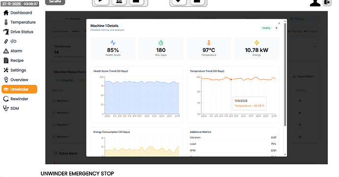

Mappview's webviewer Supports Tailwind css components?
Hi, community.
is our Mappview’s webviewer widget is capable of showing the websites built on tailwind css ?
as currently i checked on mappview 5.24.1 it is not supporting.

It depends on what “is webviewer widget capable of showing websites build on tailwind css” means.
The WebViewer widgets is, as you already pointed out, “only” a wrapper around an html IFRAME element. Due to that, you get some restrictions, which are enforced by html and the browsers itself. Typical example is a website not allowing embedding it using an IFRAME. Other example is the force of using https.
Besides that, the IFRAME is like a common html “browser” - everything which complies to HTML standard (and does not collide with the mentioned restrictions!) should be shown in it without issues. tailwind based websites are normal webpages, just doing the styling a little bit differently …
One challenge might however come up: tailwind is optimized to support different screen sizes and resolutions. In mapp View (most) widgets have a fixed size - so you might not get the full potential of tailwind.

It should be possible, since Tailwind produces a static CSS file.
However, you should avoid using the CDN version, as it requires an active internet connection.
Instead, generate a static Tailwind CSS file locally and include that in your project.
I implemented it by hosting the Tailwind-based webpage on the PLC web server and then displaying it in MappView using the WebViewer widget.
I tried the same website with hosting it locally and it is showing on mappview hence it is a security policy related issue so do we have access to modify it?
However after running it locally i still got error for some components
This error is not related to Tailwind. The syntax you’re using isn’t valid in plain HTML, so it looks like your webpage is relying on a templating framework or build process?
In the WebViewer, that templating logic is likely not being executed, which is why data becomes undefined and you get the error.

I’m using Next.js so hosted it locally and on the browser this is working correctly
initially i thought next.js latest version might not be supported so i downgrade it to v14.2.16
well some components are working fine
So what was the cause of your problem?
still encountering this issue on my locally hosted website for certain components :smiling_face_with_tear: it might be due to problem in my code since
everything else is functioning perfectly. :upside_down_face:
