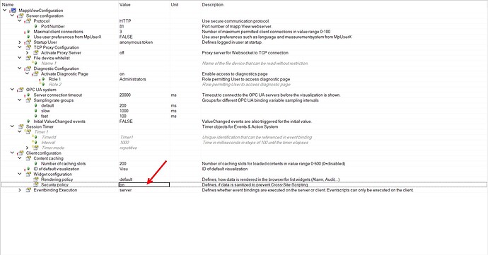

The reloading is a typical behavior when the clocks are different, but we already checked that. I dont think this is an issue of the iframe since it works fine on the T50. I would go back to the original IP of the modem with 192.168.20.70. There are two more things that you could try.
Set security policy to false. Do a full rebuild and download the project.
Go to the CPU configuration and set the modem as Gateway. Do a full rebuild and download the project.

Hi Stefan,
I’ve tried both options, still the same result.

So I did some testing myself and I believe the issue is that the embedded visu uses HTTP instead of HTTPS. Can you please add a certificate to the visu that you embed following the attached guide. You only have to create the certificate, change mappView to HTTPS on the embedded vis. Then use https://192.168.0.21 for your web widget.
How+to+use+your+own+certificate+with+mapp+View+and+import+it+into+Chrome.pdf (677.4 KB)

Hi Chiel,
yes, the normal certificate is fine. Make sure the date is far in the future. On the T50 you can choose to ignore certificate errors.
Hi Stephan,
Accessing https://192.168.0.21 results in the right visualisation with the certificate error.
The 192.168.0.20:81 shows the result below. The T50 does not show anything in the WebViewer
